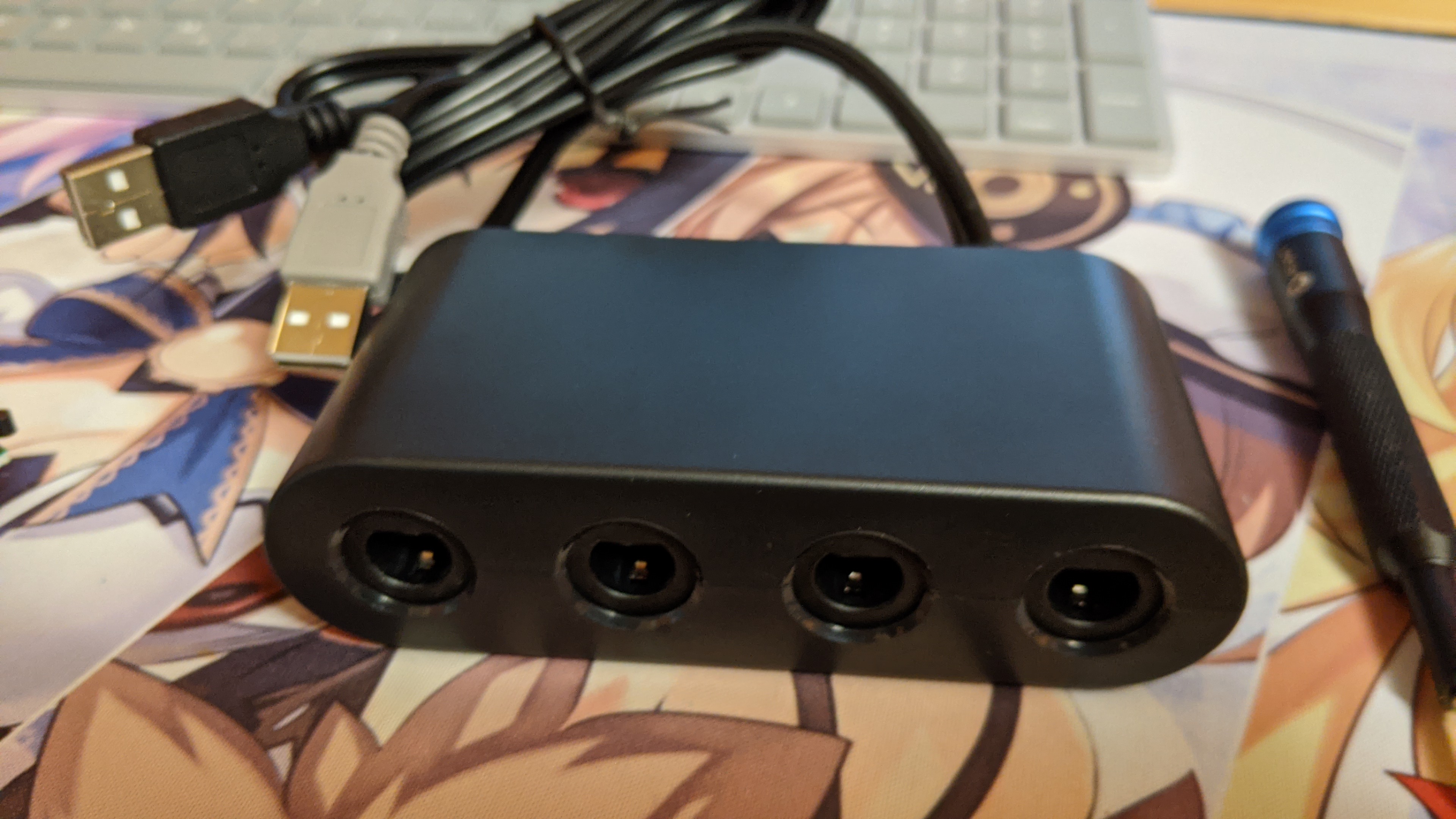

Also, I looked at that and I will just remove the Gamecube stock controllers port and simply put a Gamecube adapter there. The one used by Madmorda in her Gamecube Switch Dock as the same spacing than on the Gamecube and it’s just compact in one board (but would not solve the GPU power connector issue), instead of trying to fiddle with the Gamecube stock ports.

Received the Gamcube adapter, but need to return it because it doesn’t work. It’s detected by the pc, but no input received whatsoever. But still disassembled it to see if it would fit the bill and yes. The fact that it would allow for some clearance below the ports mean that the PCB of a 1050 or 1650 would fit underneath up to the circular heatsink and would give the precious millimeters I need so the card doesn’t interfere with the back panel.
