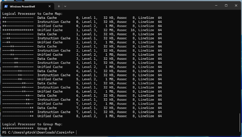

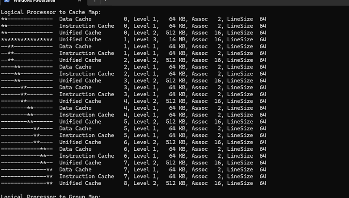

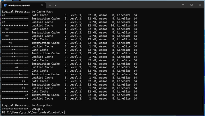

Discovered <cache mode="passthrough"/> today which had a pretty noticeable performance impact on my win11 virtual machine which has me wondering if there are any other settings I might be missing.
—Default config mode—
—Passthrough config mode—
