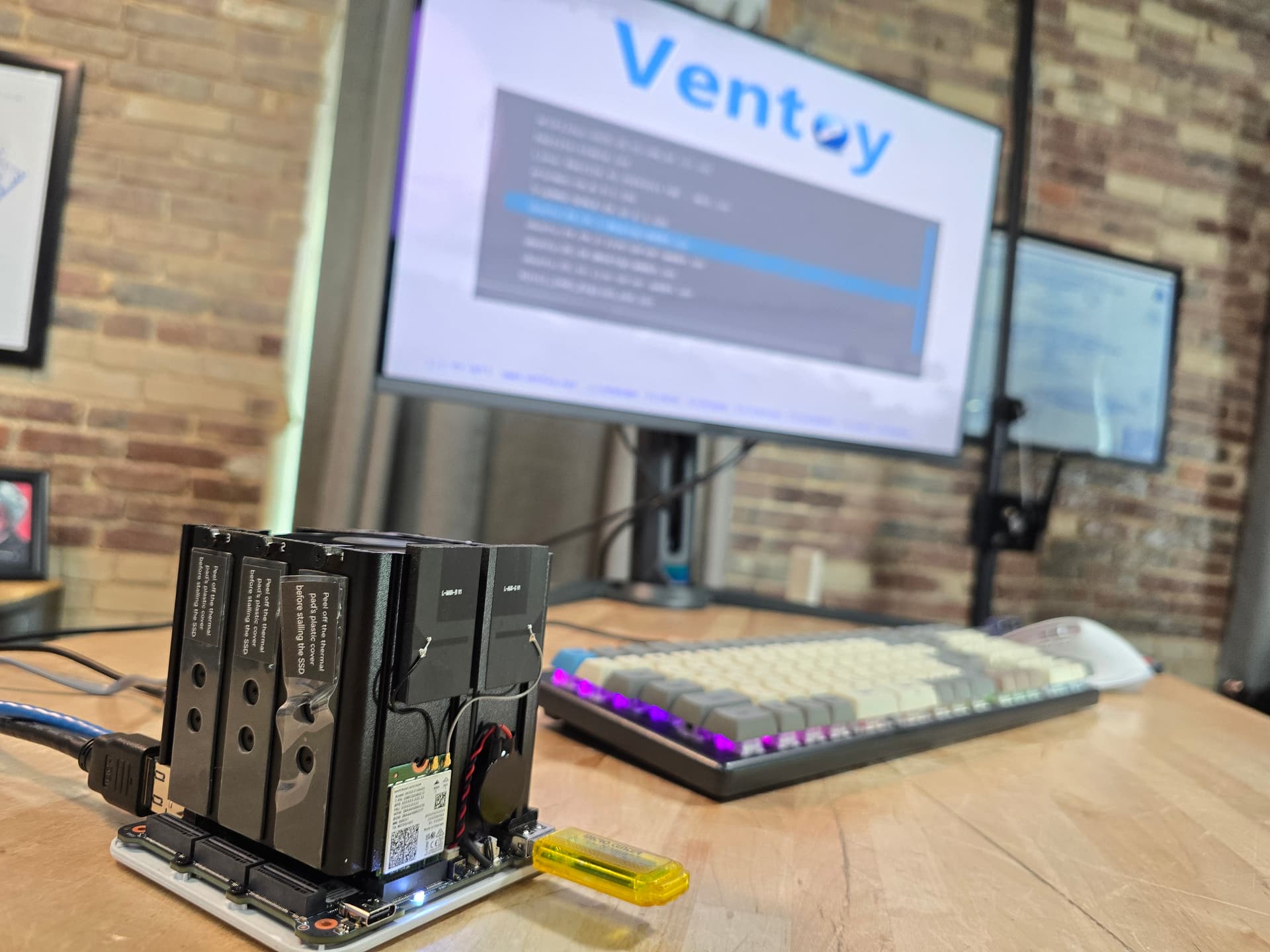

This is the Beelink ME mini
It’s an Intel N150 + 6x NVMe slot mini PC. It’s base price is about $209 or about $329 as configured in the video.
It has 64gb of onboard eMMC which is great to install a hypervisor, and dual Intel 226v 2.5gb nics.
I tested Windows 11, OpenWRT, Ubuntu 25.04 and Proxmox 8.

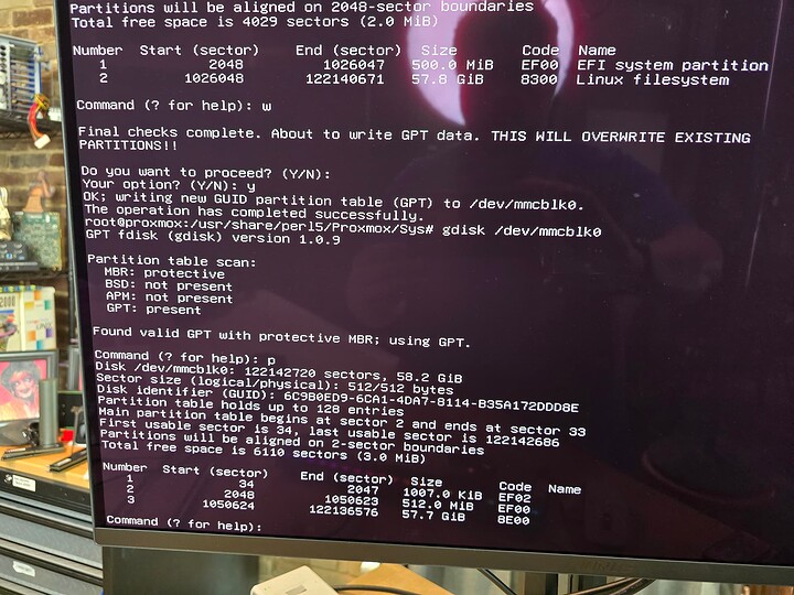

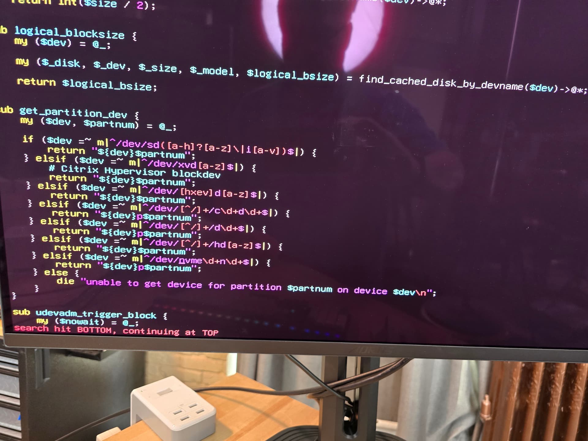

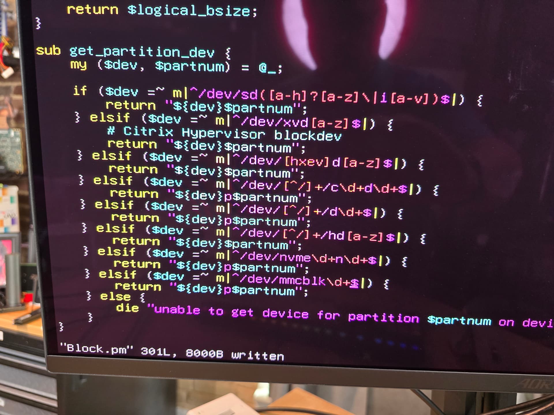

proxmox install bugs out for mmc
The problem is the proxmox installer crashes if you try to install to an mmc type device.
Fixing this is not too hard – boot the installer, drop to a terminal (CTRL+ALT+F1) and press CTRL+C to abort the installer. That’ll dump you at a prompt. You can use vi or another editor to edit /usr/share/perl5/Proxmox/Sys/Block/pm – search for nvme and add the two lines below as I have.
starting value of my file
what I edited it to be. This is the fix. That last elsif with the /dev/mmcblk conditional is what should have been in here since 2018, but I digress…
Also, launch gdisk and to create initial partition because another bug elsewhere that will still crash the installer if no partitions exist at all on this storage device when we start.
Once you have written out the new partition table, run lsblk and confirm you see mmcblk0p1.
From there, run proxmox-tui-installer and proxmox should install normally when selecting the 64gb mmc drive as the primary drive.

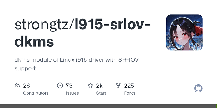

Passthrough iGPU
Once you’ve verifired you can ssh into the machine over the network, if you want to pass through the iGPU to a virtual machine, it is possible on this platform. Refer to the video for the bios settings to make sure you’ve got the iGPU set properly and SR-IOV turned on.
We’re going to use this:
… and this is also an excellent resource:
and while we aren’t going to use Windows, the sr-iov gpu devices DO passthrough just fine to the VM you want to run Jellyfin or Plex on!

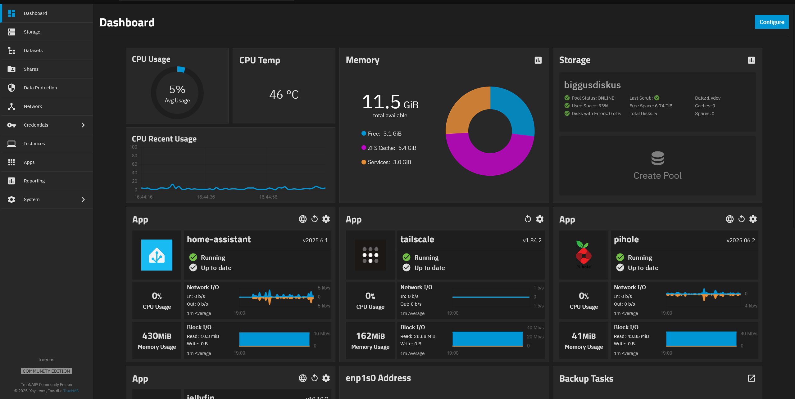

I bought one of these two weeks ago. Messed around with it’s Windows 11 install, Proxmox, Unraid, and TrueNAS.
Ended up settling on TrueNAS with 5x4TB NVME drives in a Z1 pool and 1x Intel Optane 16GB M10 boot drive. The EMMC causes issues with nearly every OS installer. The Optane drives are also super cheap @ $2-4 each. I bought five for $15 delivered.
It’s not speedy by any measure. Though it’s a damn sight faster than reading and writing to my old NAS with gigabit ethernet and SMR drives. The size and power consumption are near unbeatable.
For apps, I’m running Tailscale(it’s my new endpoint), Pihole, Home Assistant, and Jellyfin.
