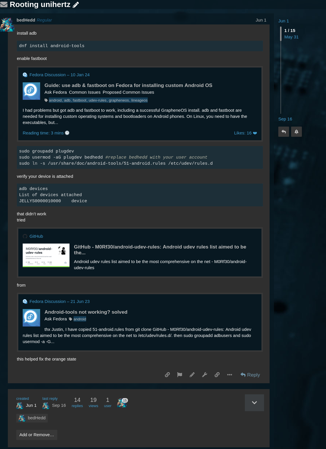

The first documentation was for how to get my fedora desktop to talk with adb. Previously I had been calling a adb folder. The guide gave me a package I can install so that I wouldn’t have to call a script for adb
It took a couple attempts before I got it properly working. This initially helped me figure out why the fastboot devices command didn’t work
After I got a image flashed, I couldn’t figure out why adb couldn’t detect the flashed image
The findings there got updated with the section. The additional instructions for fastboot were as a result of getting errors while flashing lineage os
Once again, having chatgpt help me get the correct terminal commands to debug my issue.
