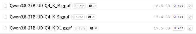

This is ridiculous cope. Here is every unsloth Q4 quant. Which one of these is 19 gb?

The UDQ4K XL is 19GB after you include the 1GB MMPROJ file for vision. So nice work in doing your best to try to make me look like I don’t know what I’m talking about, only to prove me correct.
Here’s the list of files, since you seem to not know how to read or do math. I know it’s hard for certain people, especially those who are so far behind others and really spend the time to put other people down and tell them that they don’t know what they’re doing, even when they’re trying to help out other people. So you can take this self-own and maybe think about your actions before you post again. Overall, the models that you linked prove me correct. Not only is the MMPROJ required in order to actually use all of the models’ capabilities, because all vision will be disabled without the additional 900 plus megabyte file, but to enable MTP requires another roughly two gigs of scratch space in VRAM. So when you boot the XL model, which is the one you actually want to use if you want full accuracy, you will be looking at essentially 21 gigs on model load before any work has been done.
