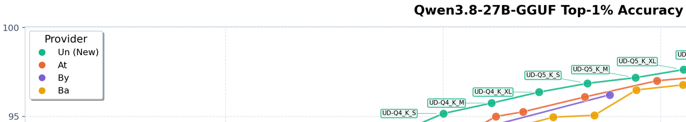

-You’re completely correct about the XL quant. Everyone knows there is a such precipitous drop in quality from Q4_K_XL to Q4_K_M such that Q4_K_M is unusable, as you can see here:

I could, but there is no point. I just use Unsloth Dynamic Quants and so do most other people. Which is why they have taken over the downloads on HF by such a large margin. Because they deliver what other Quants don’t.
AesSedai does some good dynamic Quants as well.
