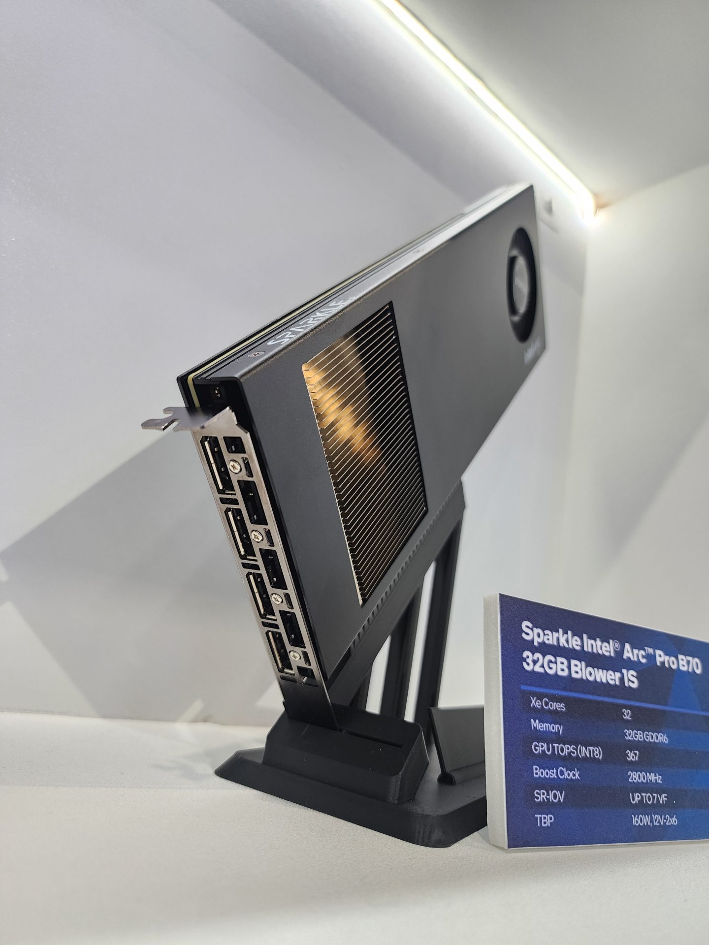

This looks interesting, although I donโ€™t suppose it changes anything

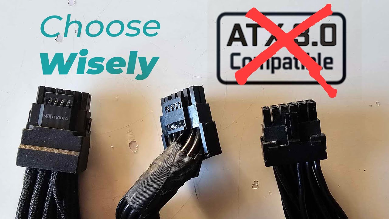

Most certainly do not use any kind of adapter cable, you gotta go all in on 12VHP with a new PSU built for it.
Though a lot of those special features for it really donโ€™t do anything special.
Or for almost the same price, you could get an M5 Macbook with 32GBโ€ฆ
Itโ€™s an official Corsair cable that works with their v4 outputs. I checked an lots of people seem happy with them? Itโ€™s a 1000W psu, Iโ€™m not sure what else would be different. Iโ€™ll do so more searching on it.
Ah, i thought you meant just a PCI-e โ†’ 12VHP
Ahhh cool, no I should be ok. Thanks for the concern though, I donโ€™t really want any fires either :smiley:
Why?
12VHP is an actual dumpster fire:
But that is due to the 12VHPWR connector. I donโ€™t see how a 12VHPWR adapter cable, as supplied with the card, is different from a the 12VHPWR cable supplied with the PSU in this regard, as they both share the same problematic connector?
I donโ€™t really see the nvidia-style power connectors as a potential problem until youโ€™re north of 400w through that connector. That connector style has been in use in servers for > 10 years and at least for the max 350w typical application there, I have only seen one melted connector in that scenario ever.

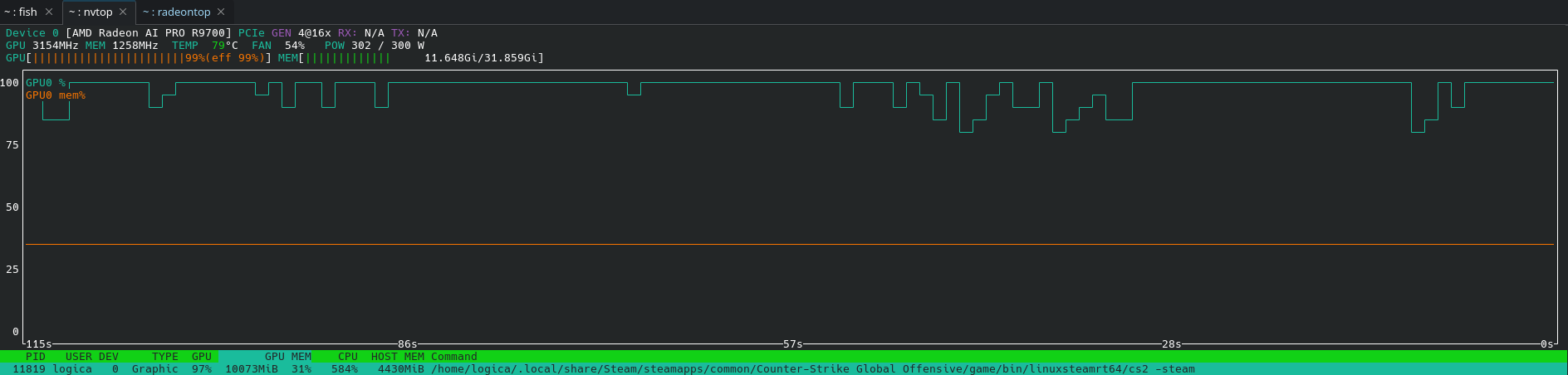

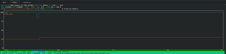

Ok, gaming first impressions. starting with CSGO:
I am kinda surprised CSGO consumes 12GB-13GB (1440p):
This card is definitely louder than the 6750. I donโ€™t have a db meter to quantify it.
Honestly, I was expecting worse. I usually play with headphones and if I simply turn my headphones up a little, itโ€™s not completely terrible. But CSGO is rather lightweight.

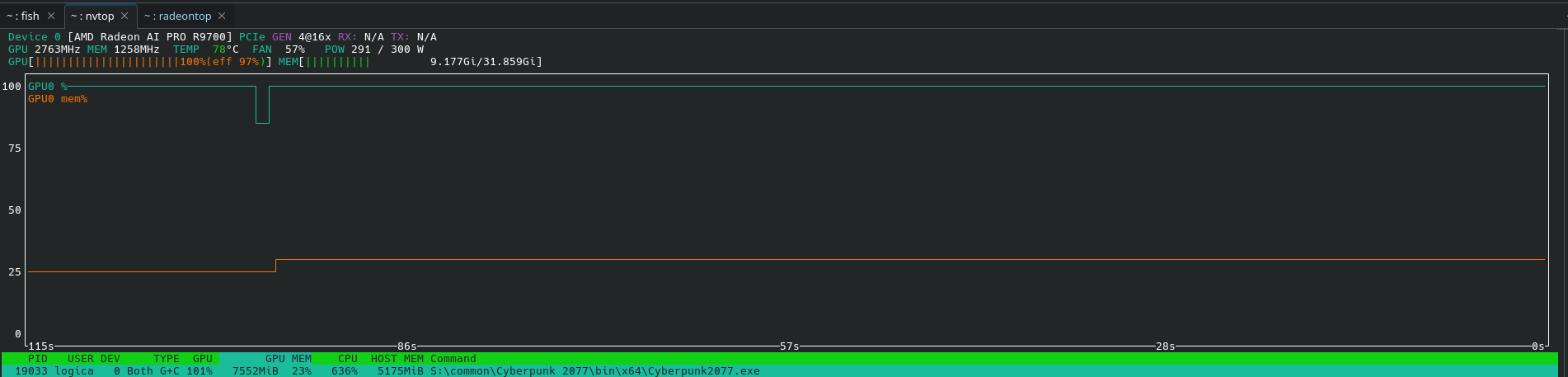

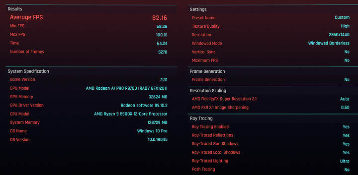

Trying out Cyberpunk now.
Oddly enough, it seems to be only pulling 9-10GB. How/why is CSGO consuming more VRAM than Cyberpunk?

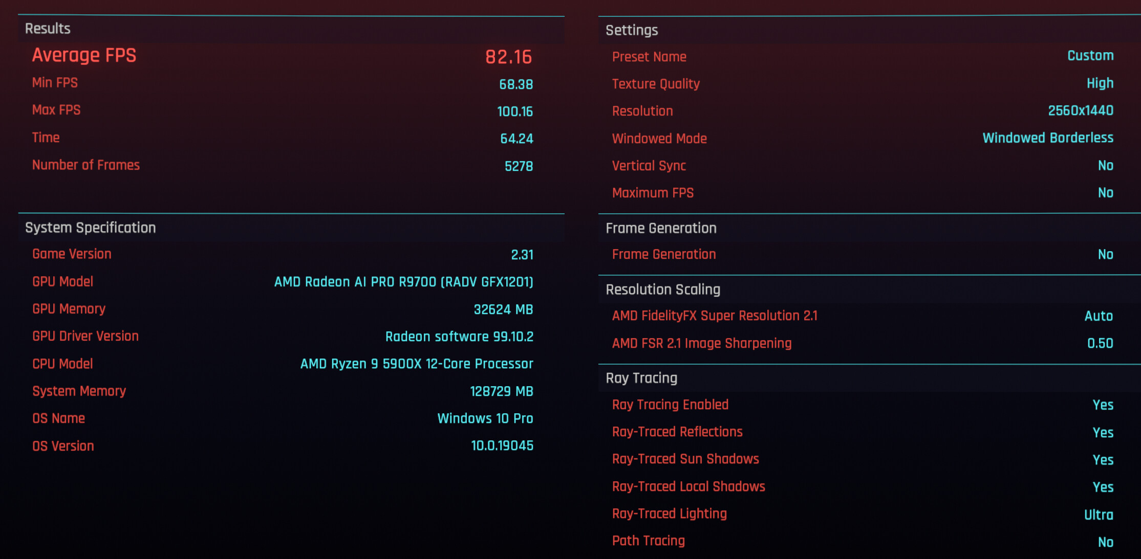

I am actually able to use Ray tracing now! The 6750 wasnโ€™t playable with Ray Trace on.

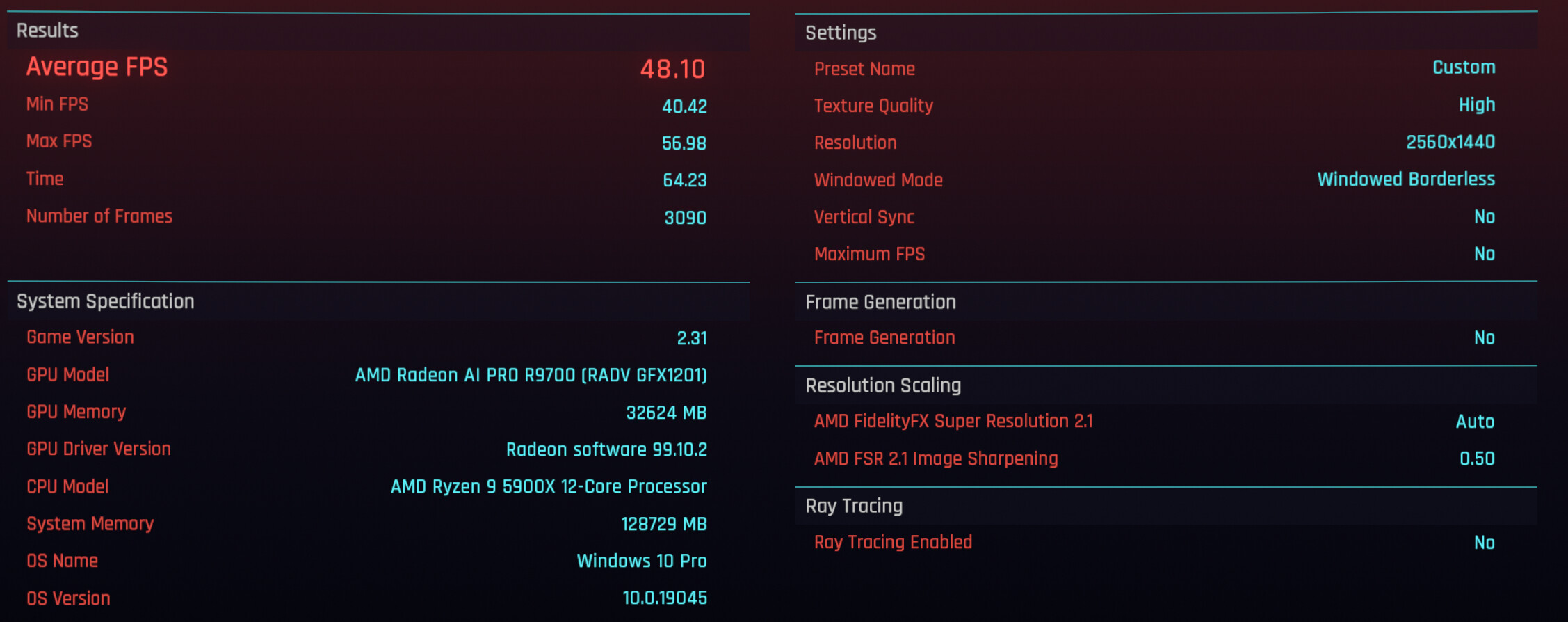

Path Trace cuts the frames almost in half:
The fan seems a little bit louder with Cyberpunk than CSGO, its definitely doing work. But still not completely unbearable with headphones on.
I think the sound isnโ€™t a terribly bothersome actually. At least not for me. Others might be more bothered by it so YMMV.
