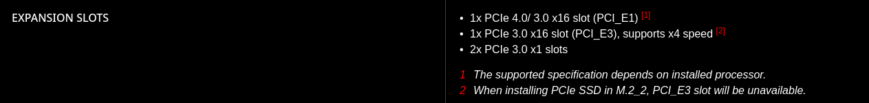

Ok, so the only board that is in stock at my local that apparently supports x8/x8 according to the support guy on the phone is the
MPG B550 GAMING PLUS
Just going through the info trying to validate this. MSi’s website says:
This looks like only x4, so I don’t think is correct?
I’ve had two liquid-cooling failures in my three decades of this hobby/career, and both were painfully expensive. As far as I’m concerned, when dealing with anything expensive that’s likely to be running for a significant portion of every day - especially when it’s critical - a big honkin’ lump of metal is by far the safest approach.
All depends on your tolerance for risk, I suppose. And maybe whether you can find somebody at the insurance company who’ll take back-handers.
Correct.
You really need to be carful with finding a AM4 (even AM5) MB that does true 8x/8x.
The best place is eBay if you can find a good seller. And it’ll largely be x570 boards. X570 Aorus Pro Wifi being a prime example, but I think the AsRock Taichi is another.
DS is correct. Games don’t really benefit at all from x16 to x8, unless it’s PCIe 3.0 as the bandwidth for 4k can saturate an x8 Gen3 bus IIRC. GN did a video about it years ago, going all the way down from x16, x8, x4, x2, and x1. IOW, “not really, no.”
LLMs, yes, usually a little bit in my opinion. Most noticeably is prompt processing I’ve seen with the same GPU drop about 30% PP in pcie3 and pci4. Inference token gen - a bit as well.
