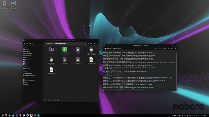

I’m sorry to revive this mummified thread but I’m trying to convert my setup to Linux and I use the live gamer 4k for capture and I tried building this custom driver but I get an error partway through and I cannot find any support page for the original driver it was based on. I am by no means a Linux expert but I’m getting a basic grasp of how it works but this is throwing me for a loop. I’m using the latest Nobara distro which I think is based on fedora so it should work but maybe I’m doing something wrong?

You should probably mention the error because we can hardly divine what you’re seeing…
But ignoring that, that repo also hasn’t been updated in 5 years and I’m not sure if the AverMedia driver has either. Meanwhile the kernel has moved on so it’s very possible the code is just not compatible anymore.

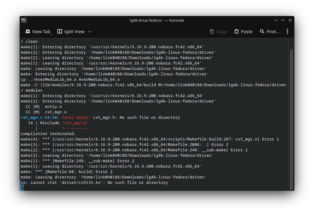

sorry i dont know why i didnt screen shot it did it again just now without changing anything and got this same as last time

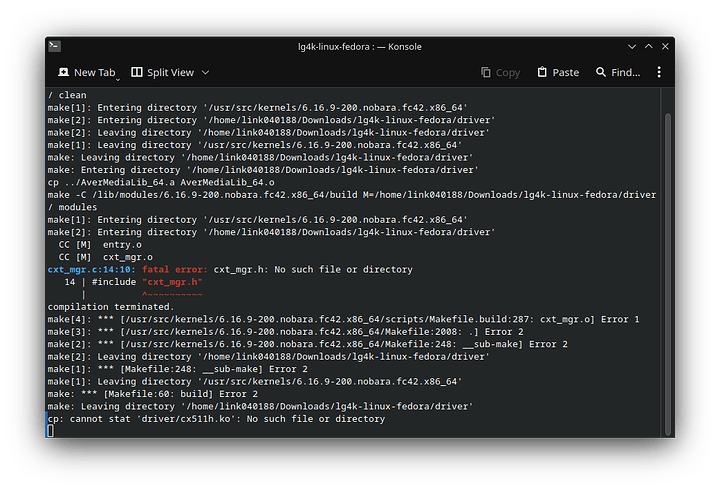

i also ran the fedora branch version and got this
Yeah as I said the driver probably just didn’t keep up with recent kernels. Their Pro cards probably only officially support Enterprise distros with ancient kernels.
