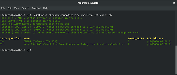

The gpu-pt-check.sh script now automatically checks if AMD-V / VT-X and if AMD’s IOMMU and Intels VT-D is enabled in the UEFI. It also checks if the IOMMU kernel parameters are set. I also improved the logic for checking if the IOMMU groups allow a GPU to be passed to a VM and made the script print the information in a more readable way.
I think this looks pretty okay:

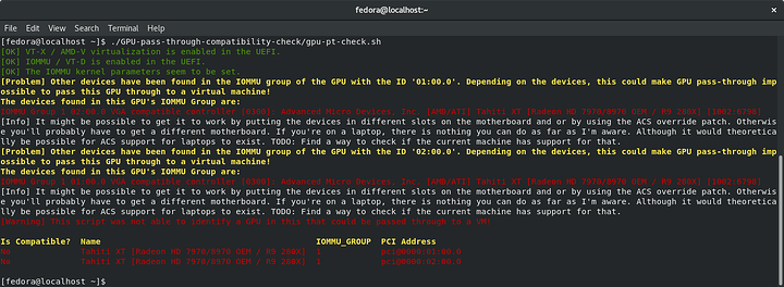

In some cases it may still report inaccurately. For instance I found a case where you could only pass all GPUs together:
Edit2:
The script can now handle cases like the one mentioned above.
