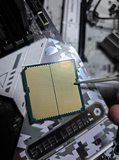

Of the boards and cpus we got from viewers and supporters, we mostly got 7800x3d and 9800x3d CPUs, with one or two 7950X CPUs. The discoloration is in different places on our test CPUs, and they present with different symptoms.
What boards did you focus on?
The B850I Lightning Wifi
.. this board did not murder any CPUs, despite our best efforts! :frowning:

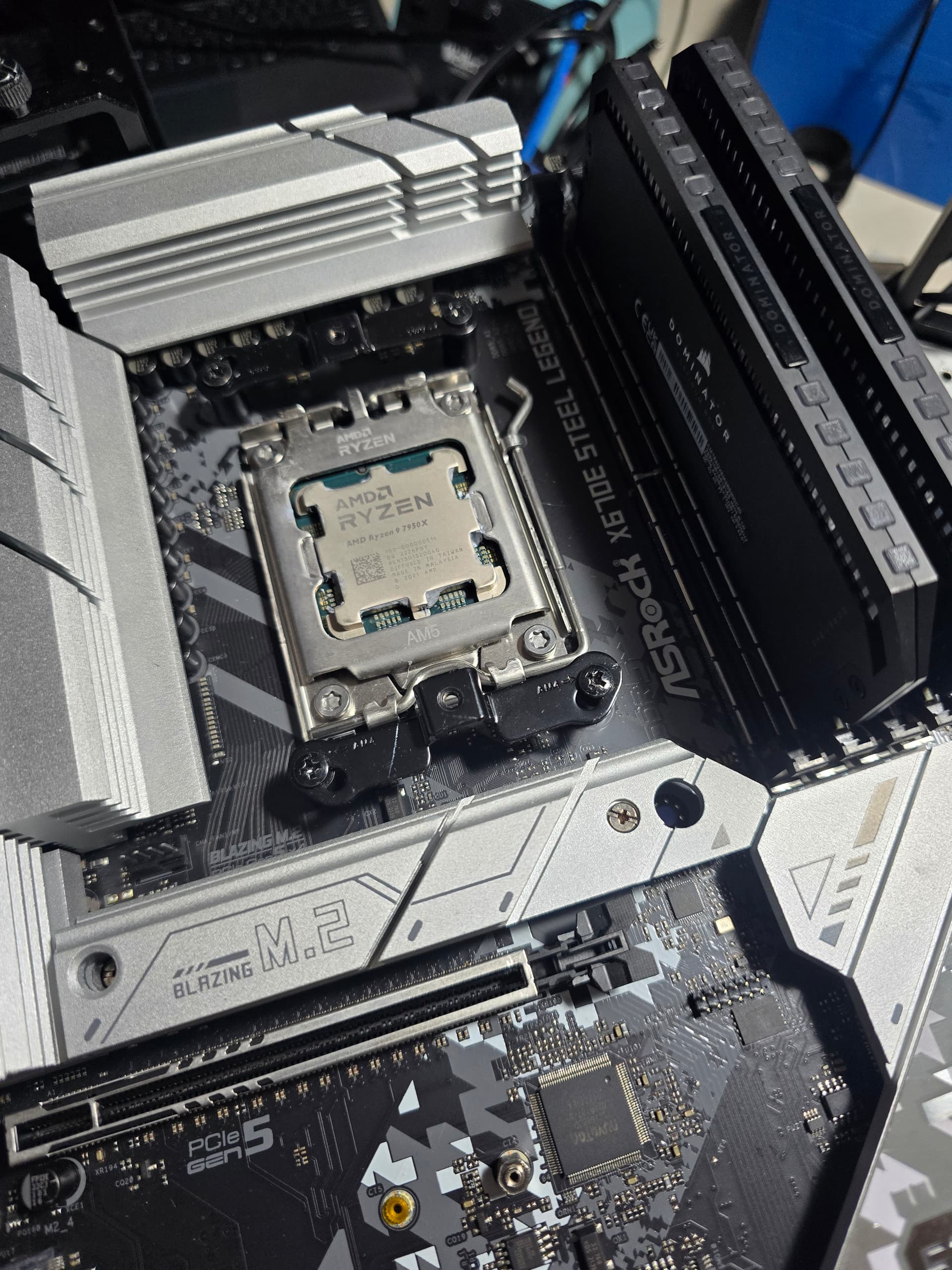

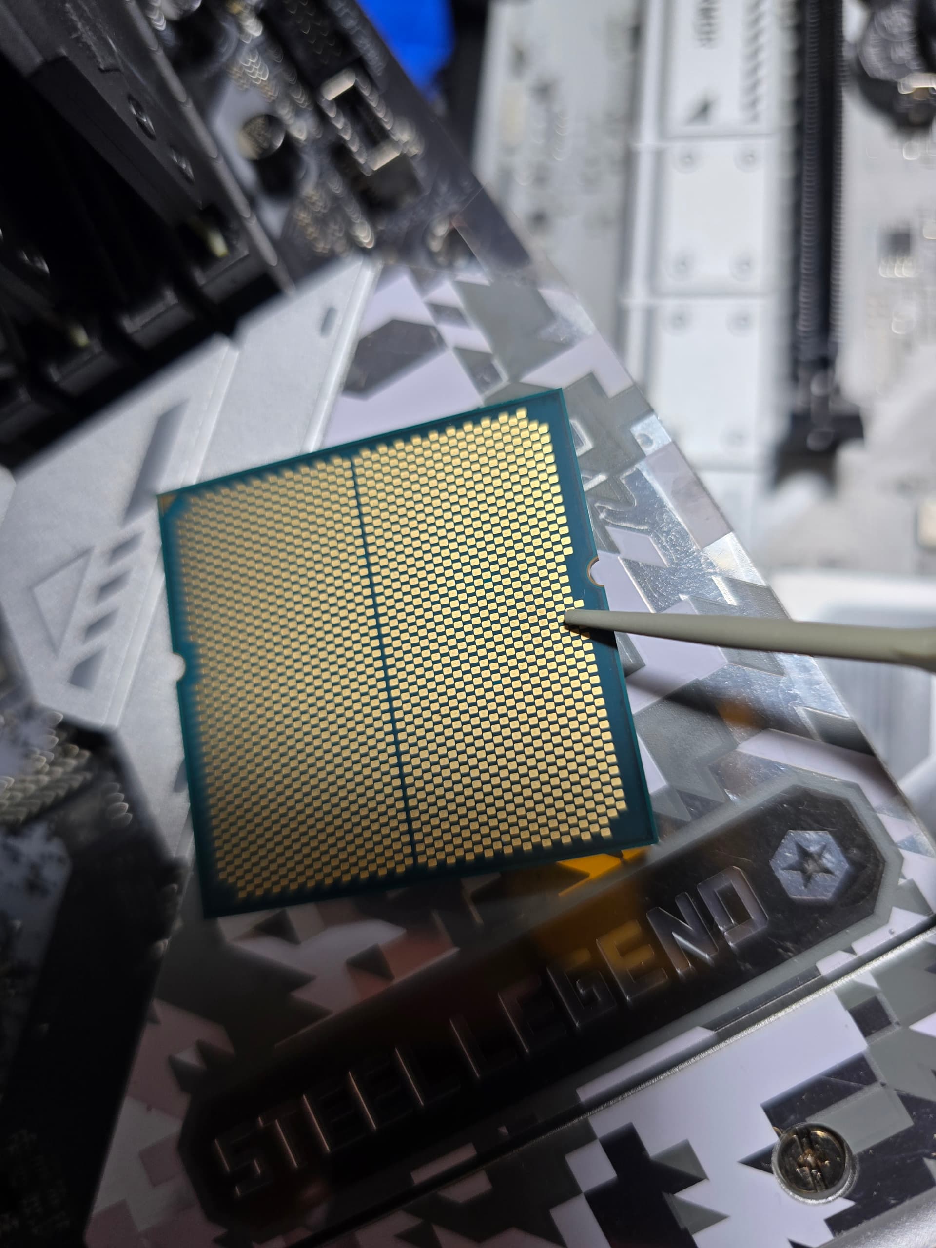

The x670E steel legend
While this board has not murdered any cpus, it is oddly flaky in unexpected ways. We observed some minor discoloration on the CPU when we got it in from the end user. Cleaning the discoloration has not resolved the flakiness on this board. We aren’t sure it is related.
We replaced the socket on another motherboard that for sure killed a CPU. It hasn’t killed again.
The other two boards appeared to have damaged sockets. We do not believe the sockets were damaged from factory. It may have been cpu misalignment during installation, or possibly excessive heatsink pressure (though we doubt that).

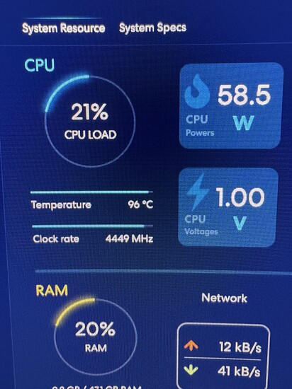

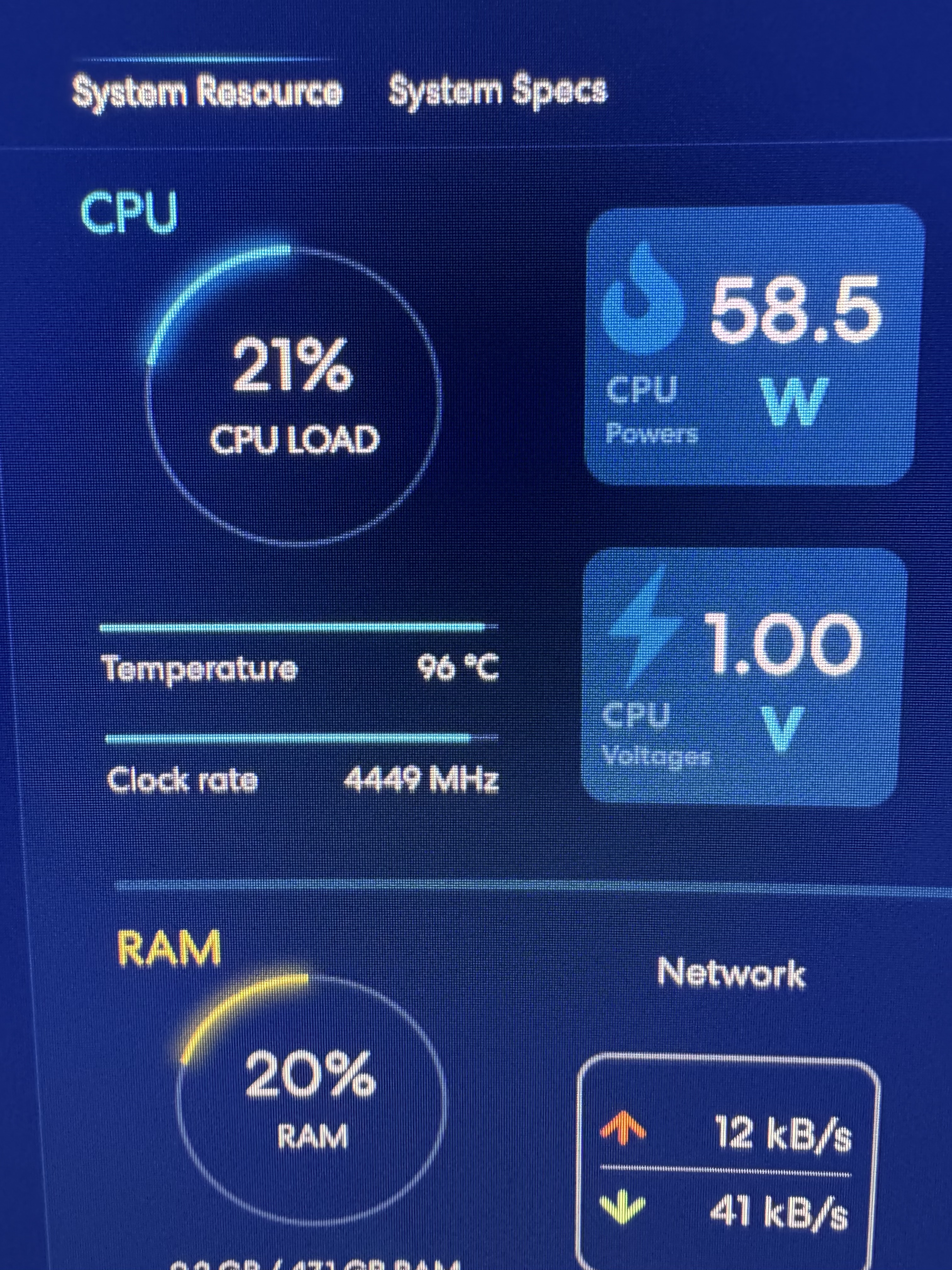

How is it so hot with that wattage and load? Not enough thermal paste?

I always spread the thermal paste. Temps are normally in the high 30’s and lose 40’s. This only happens if I have to restart cause of an update.

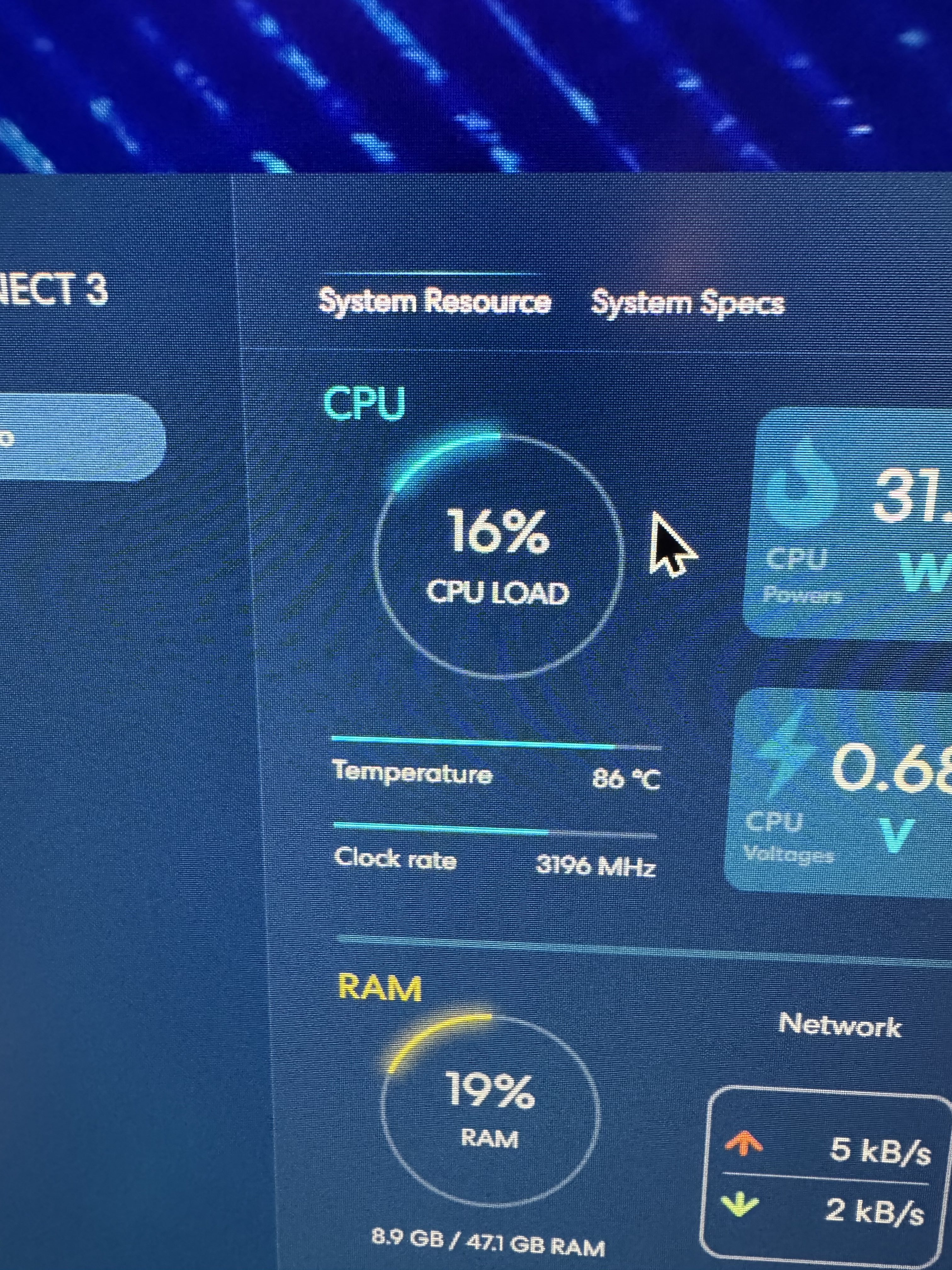

Here’s a new that just happened after updating the bios.
I don’t think that is anything to worry about. It probably just means that the area close to the themal sensor got really hot or who knows what temperature sensor that software is polling. Use Speedfan or CoreTemp or QuickCPU or OCCT etc. to verify.

that sounds like normal behaviour, windows does a lot of work after patches. I do not see any relation with the topic…
With all the builds I’ve done, this is the first time I’ve seen that happen. Thank you advising.
