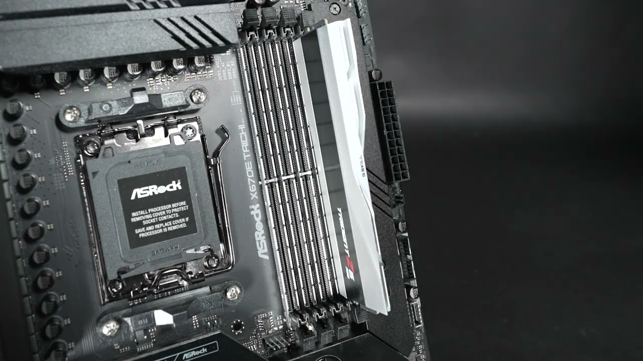

Asrock currently has bios v3.20 released which should resolve the issue.
However for the X870E Taichi boards specifically that bios version is still listed as Beta.
That might be an error on their support page but (be cautious anyways).
