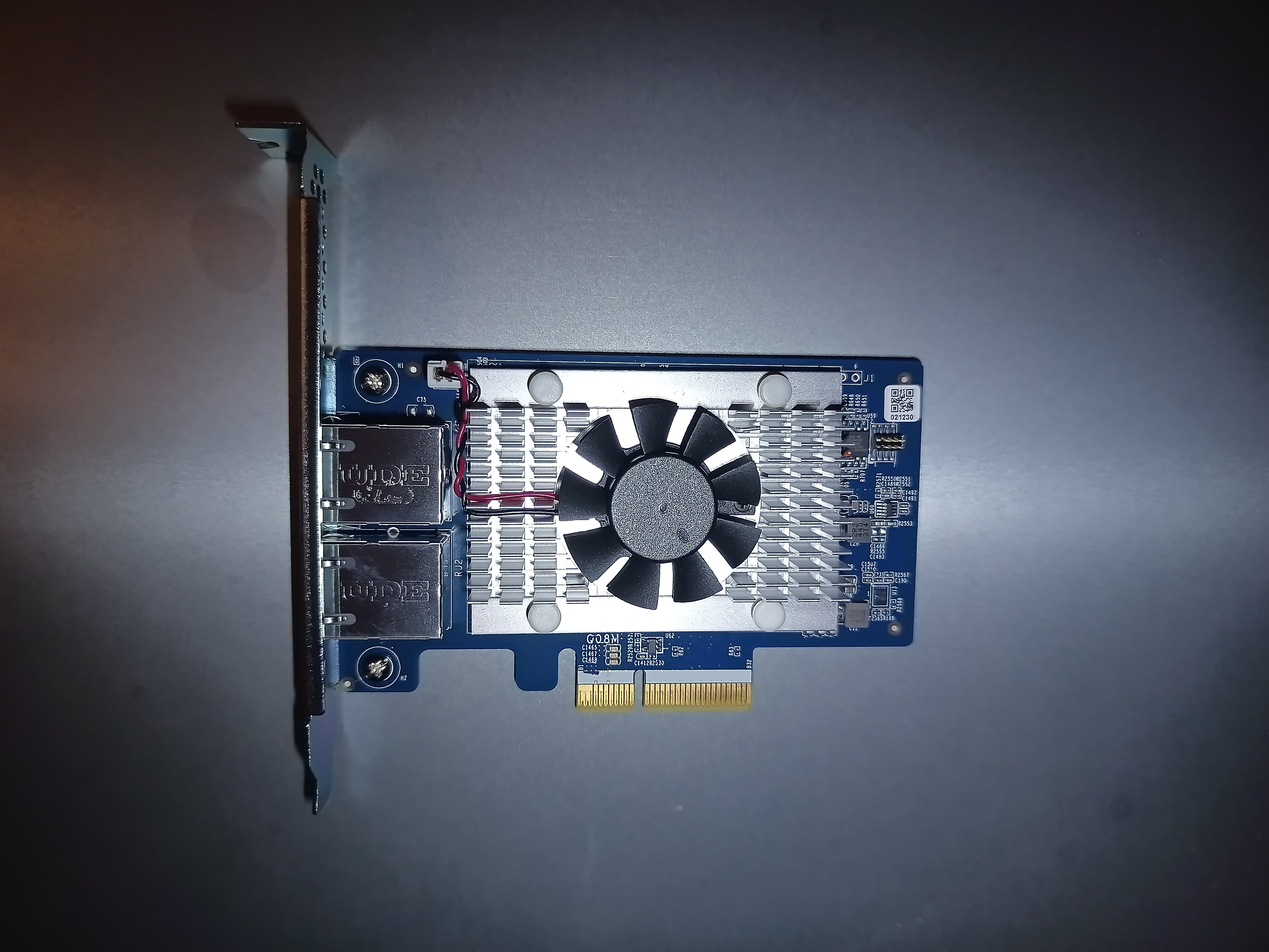

I’m replacing my AQC113 today after dealing with instability for the past 2 months. I had tried everything I could think of and came to the conclusion that the hardware is bugged. Tried higher and lower spec’d cables, all the different permutations of power management, packet coalescence and buffer settings, extra cooling for the card and have been running the newest 3.1.10.0 driver the entire time.
I’m going with Intel’s lower powered x710 for reliability now:
