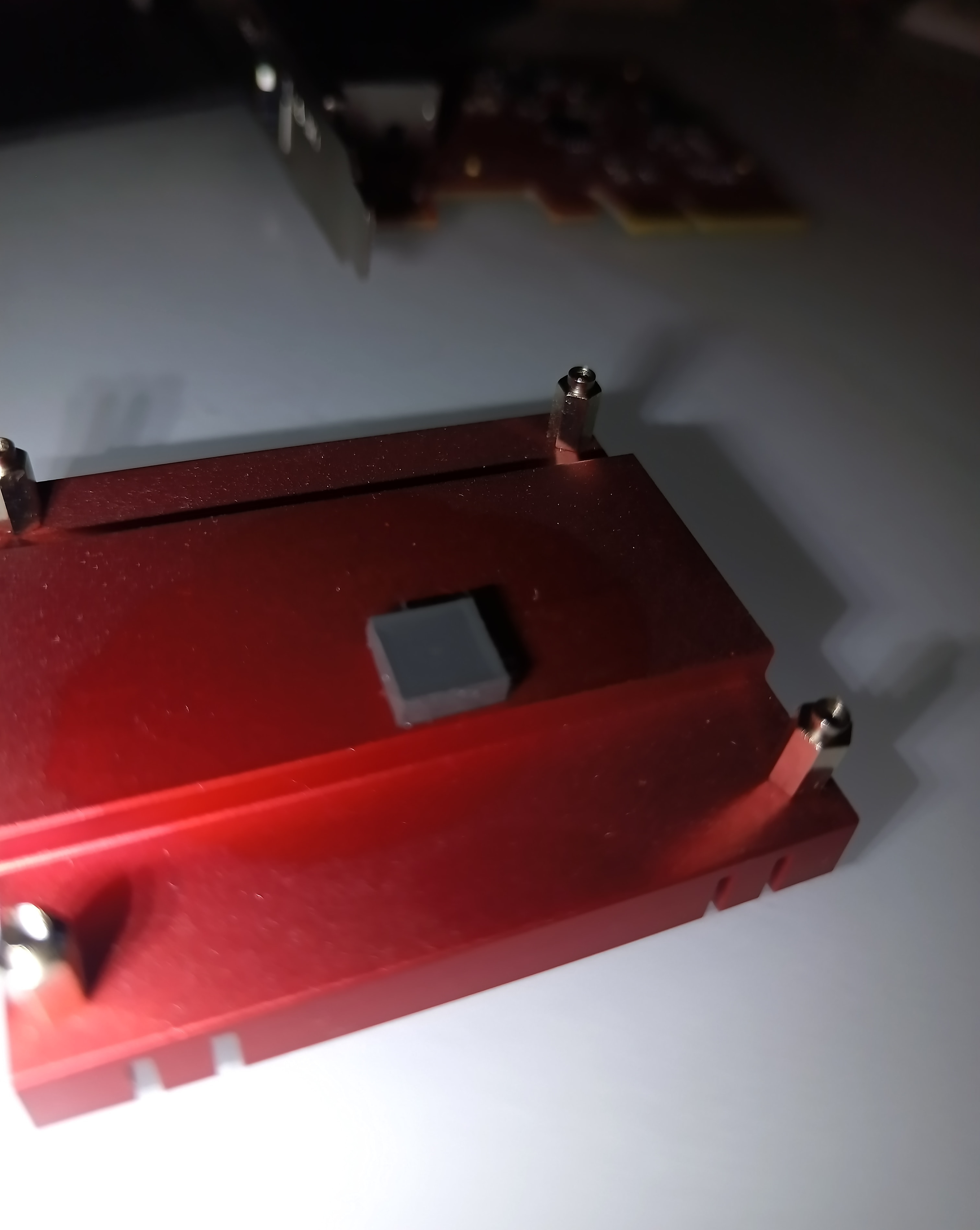

I have a small update on the ASUS AQC113 v2 NIC:
I had thought it was being cooled properly because the heatsink remained cool, but upon taking the card apart I found there is a ⅛" thick piece of rubber directly between the AQC113 and the heatsink so my assumption that the chip was being cooled might not have been accurate.
That might be a thermal pad, rather than rubber?
It’s super resilient, it will spring back just like rubber even if I stab it with a screw driver:
I’m pretty sure it has silicone in it though based off of the residue around it.
Looks like you can replace the default standoffs with shorter ones, and hence use a thinner thermal pad.
