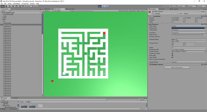

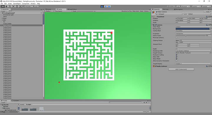

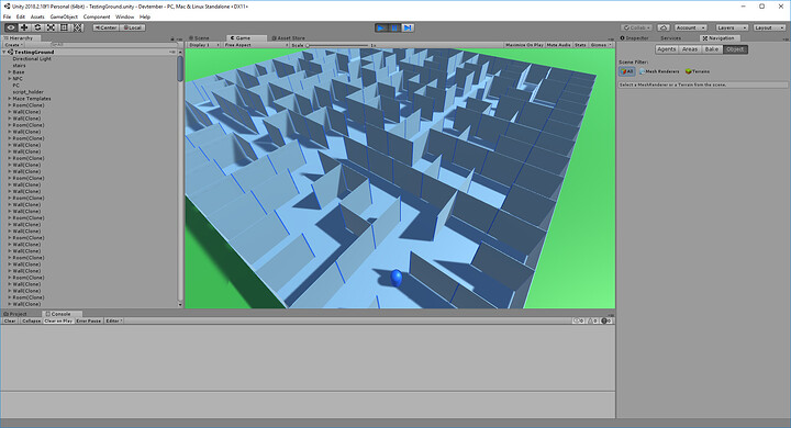

A couple of hours later and I had another go. Went back over the code for generating the maze and found some bugs. It was stopping a bit early making the rooms. Looks like some defects in the maze generation, repeated cubicles down the sides etc…
Also built new template objects. A simple room with four posts in the corners, and a door/wall that can fit between the posts, and be rotated to any of the four positions.
It is much easier to build up the maze now. Just spawn a room for every Room[x,y] class, and build the walls as before.
The navigation stuff wigs out if the maze is over about 15x15 rooms though, and drop to <1FPS. That’s a later issue though.
