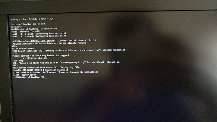

Does it throw any errors?
input
sudo tty
output
/dev/pts/0
input
sudo startx
output
_XSERVTransSocketUNIXCreateListener: ...SocketCreateListener() failed
_XSERVTransMakeAllCOTSServerListeners: server already running
(EE)
Fatal server error:
(EE) Cannot establish any listening sockets - Make sure an X server isn't already running(EE)
(EE)
Please consult the The X.Org Foundation support
	 at http://wiki.x.org
 for help.
(EE) Please also check the log file at "/var/log/Xorg.0.log" for additional information.
(EE)
(EE) Server terminated with error (1). Closing log file.
Press: Ctrl+Alt+F4
Then in the new terminal:
$ sudo startx
@Just_Lurking
startx without sudo
