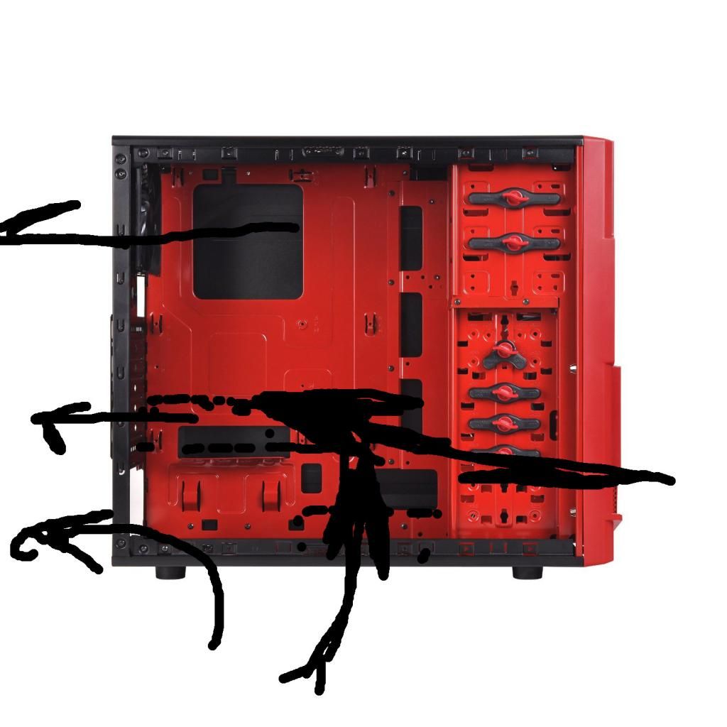

tallgeese, did you even look at the caes? the psu is bottom- mount
so you need one exhast on the rear of your case, and just moreair going in than out
I have one pwm on my motherboard is that enough?
If you had ever built a pc before you know you can easily flip it upwards. Sometimes it is more benifital to airflow. I was simply trying to let him get the answer himself instead of stating it.
Put a 120mm in the front, a 120mm in the bottom and point the psu fan downwards. This will give the most optimal cooling for this case.
Okay What is the PWM For and is 1 enough for 3 fans?
umm.... maybe you missed this as a kid, but hot air rises, and besides, you have a huge gpu separating the air in the case, if you exhaust is allin the bottom, than the IMPORTANT stuff, like THE CPU are not getting any cool air
you don't need 3 intake, what mobo do you have? you can get pwm splitters, all the connectors to your motherboard are doing is sending a signal. pwm is just better controllable.
It has a rear exhaust fan included. Guess I could have been more clear and said ADD 1 fan to the bottom, and 1 to the front.
ok, that make alot more sense. I agree.
