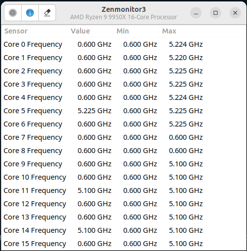

Beg to differ, this is a screenshot of Zen3 monitor as root to be able to read the MSR registers for power usage. PC is only running per CCX, not any PBO or anything else not default other than memory EXPO and the perCCX at locked 52.25/51.00 multiplier at 1.27V.
Package power at the top of the list shows 280W. Running my normal BOINC workload at 92% core utilization and also driving a 3090 and 3080 Ti besides my normal cpu tasks.
No changes to default power settings.
PC normally pulls 1075 watts from the UPS with the 3090 and 3080 Ti power limited to 265W because allowing any more exceeds the APC SMT-1500C UPS 1000 watt overload limiter.
Given the multiple obvious reporting bugs there I’d suggest using a reliable tool or measuring at EPS. Even if you have actually juiced your 9950X to 286 W sustained the prevailing body of dual CCD data remains mostly ~250 W and under.
Couple other cautions I’d make are 1) in the 9950X benches I’m aware of it’s not uncommon overclocks run slower than stock and 2) 30-35+ W at idle’s hardly sipping power compared to Arrow (~14 W) or APUs (~5 W).
The only ‘obvious’ reporting bugs for zenmonitor3 is that was never supposed to handle any newer architecture other than Zen 3. Development stopped there.
However it runs correctly and reports correctly for Zen 4 as the defines in the code have the ZEN 4 family ID’s handled. Power reporting is derived from the system MSR registers directly.
Zenmonitor 3 is only reading the system registers.
When I attempted to use it on my new ZEN 5 cpus, it simply reported “No ZEN cpu found”
But I discovered that if I simply replaced the Zen 3 Family 19H ID with the new ZEN 5 Family 1Ah family ID for the Zen 3 define, the program was able to read the MSR registers for power and the clock frequencies correctly for my 9950X cpus.
But the program tries to read the MSR registers with the Family 19H offsets which have changed I guess over what the offsets were defined for Zen 3 and Zen 4. So the frequencies in root mode are wonky. But in normal userland mode, the frequencies are correct.
I don’t have the information about how to probe what the Zen 5 MSR register offsets are. It was necessary for the program users to experimentally probe around the registers in Linux based on some hints derived for what the Windows LibreHardwareMonitor app users found.
I did figure out what registers to read experimentally for my Asus ProArt X670E Creator Wifi board used for the EC sensors. I provided that information to the asus-ec-sensor module developer so that this board was added to the compatible hardware list. Proud of that.
That is how the Zenmonitor3 developer figured things out initially. I don’t have any Windows system to run the LibreHardwareMonitor app on to try and figure out what registers that program pokes.
I believe what the system shows for cpu power. It tracks with what the UPS front panel shows when the system is booted without starting up BOINC and the gpus are idle.
Subtracting about 10-15W with the monitor off and the network gateway and switches are pulling which are also plugged into the UPS, the display shows about 102W being pulled as a idle system which falls in line with what the 9950X reads in idle in Windows monitoring apps from reviews.
That covers the motherboard power for the SoC, RAM, disk drives and the fans in the PC.
