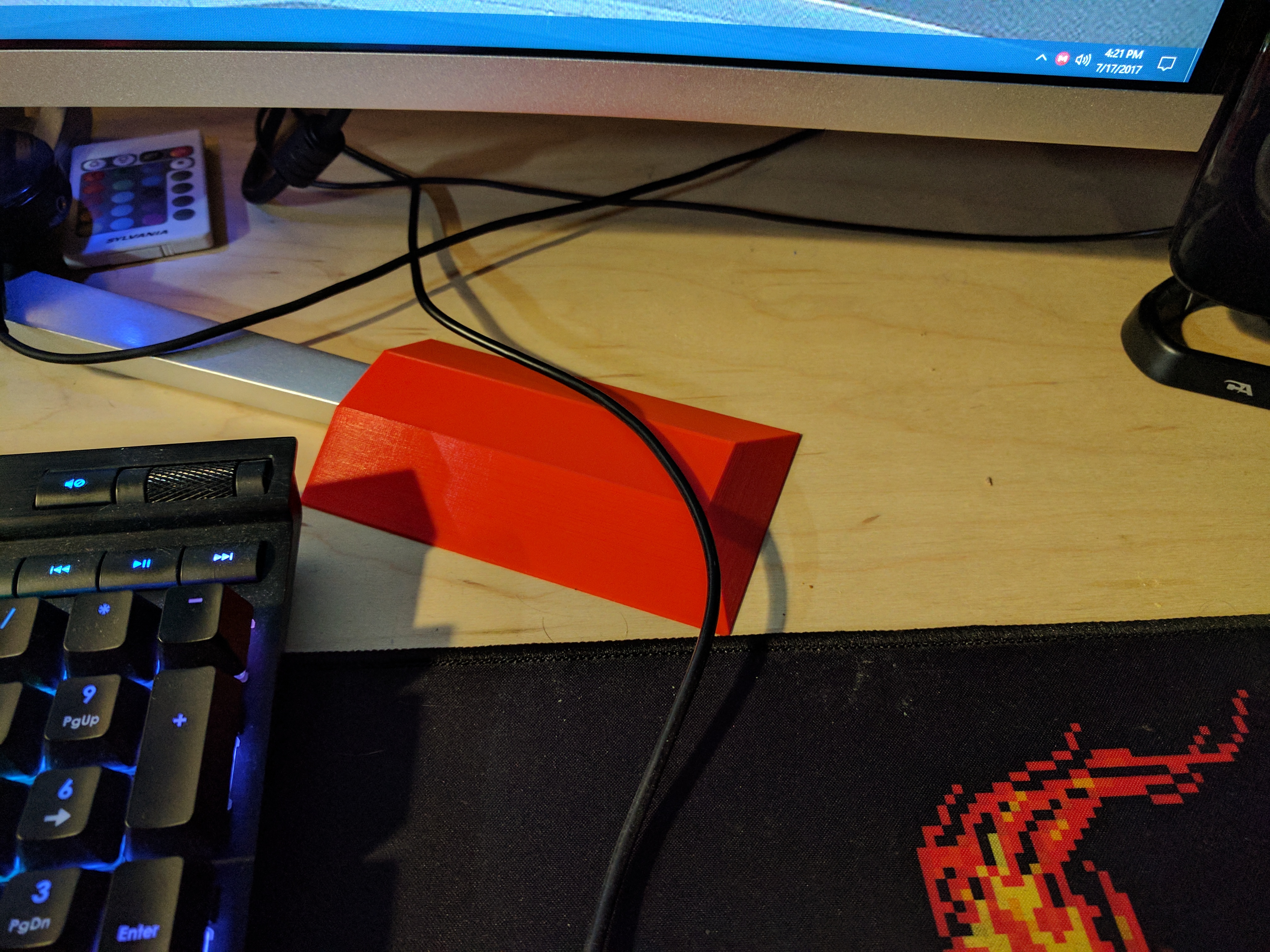

Mouse cable catching on your monitor stand?
not anymore
