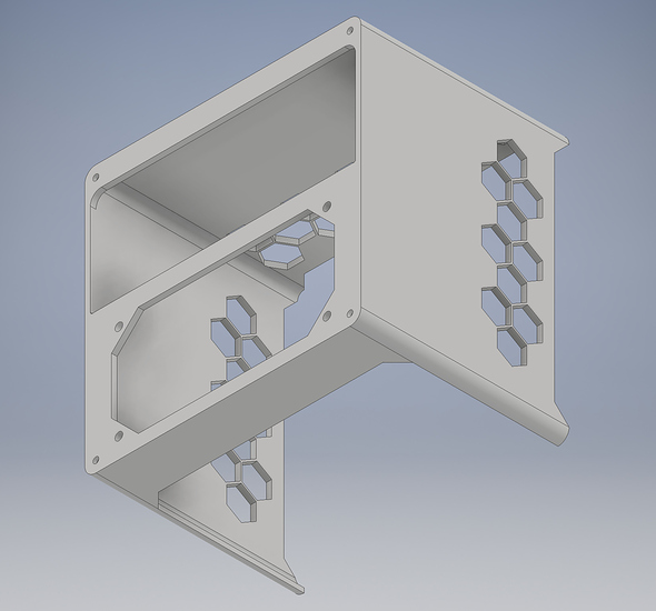

I’ll try making a new front panel for a fan later this week, if the fit isn’t too tight I wonder if a front panel attached with some tiny magnets would work…
Anyways, how wide is that power supply? I used the dimensions for an SFX power supply from Intel, but your’s looks wider. Luckily that one is an easy enough fix if it is wider.
Seems like the dimensions are right but the psu is rotated 90 degrees?
@w.meri I think what I need is a new front mesh where the I/o cutout is shifted up half a Cm and there is a cut out near the middle for a slot loading cdrom. Lololololol slot loading cdroms.

Here is what we are working with, visually
So Io cutout a bit lower, less tall and wider for a cdrom.
And existing io cut out shifted up a bit.
Lololololol
A very rough draft of a front panel with a spot for the slot load CD drive. Had to get some of the dimensions by using pixels of one of your photos. Hopefully it fits reasonably close on first try.

My next goal after the front panel is the rear panel and getting it tall enough sit vertically. It turns out there are at least five STX form factors and I think you have one of the 125mm wide ones. The feet/vertical mounting should be pretty easy though.

If anyone wants to try their hand at it here are the basic dimensions (mm) of the front panel.
export Like a baws.
Need to make the cd cutout a hair wider. It’s barely not wide enough. So maybe 5mm both sides?

Yeah, I realized the slot was probably just a hair too narrow on my way into a meeting this morning. Then I got to go to work and spend the day thinking about a space narrower than my little finger :roll_eyes: Turns out CDs are 120mm across, just like a case fan (next project = CD fan slot cover /s ).
I’ve made it 2mm wider on one side and 8mm on the other, I didn’t want to dig too deep into the outer “frame” of the panel. Everything else is unchanged.
The file with “r2” in the filename are the updated versions.

This might be another long print, it’s 113mm tall, or a smidgen shorter than a slot cover. I think with this it would bring the entire case to 150x145x266 (5.9x5.7x10.5) all put together
