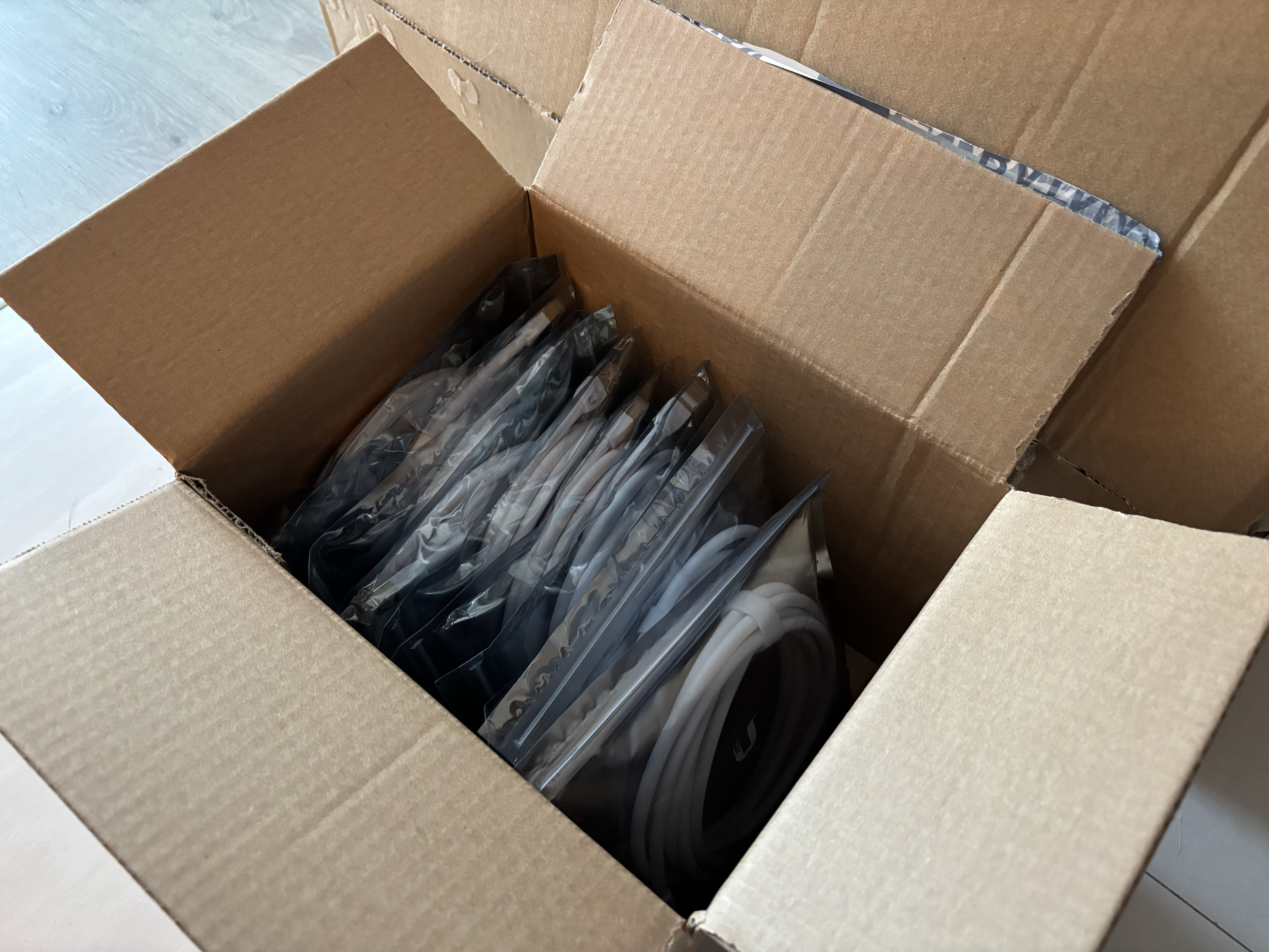

The ax router and patch cables have arrived.
One box of pricing error at the same retailer.
10x 3m cat 5e outdoor cables for 15 PLN in total. Should be enough for a lifetime for me and my extended family, lol.
I should do WiFi in my in-laws garden :thonk:
