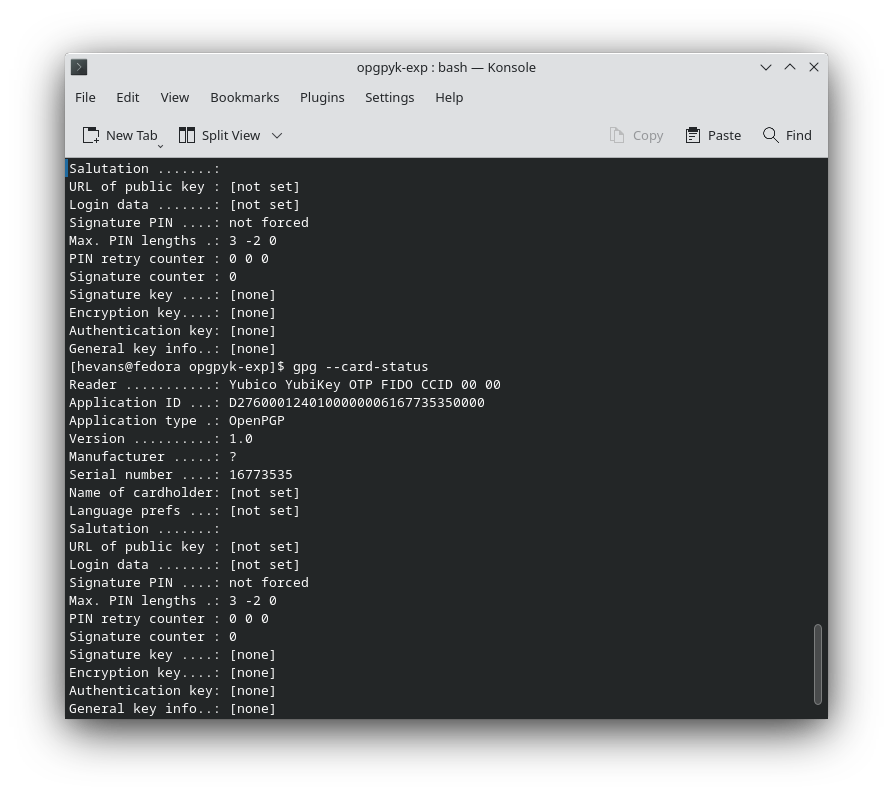

So last week I deployed a Yubikey and everything is great. I am now in the process of setting up a backup key. Everything on it is configured except the pgp key. Everytime I try to import my key it, for the lack of a better term, seems to corrupt the pgp application on the yubikey and I then have to factory reset it.
Here is where things go sideways.
I am having a really hard time with this and have spent pretty much the whole day troubleshooting it. Any help is appreciated. I am on a fresh install of Fedora 36.

Could you output your terminal history via history and provide all the commands you have used to troubleshoot. Might lead to something
Hopefully it’s not too much to sort through.
We can also try to reset the openpgp storage area on the card
ykman openpgp reset

Sorry I haven’t responded. Work picked up unexpectedly and I haven’t had time to get back to it.2 more yubikeys showed up today for my cold spares. Going to try and get back to this early next week when I get done with this job.
