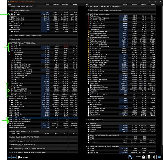

Run hwinfo portable sensor mode in background while you run your benchmarks.
Look for suspicious temperatures, how much power CPU reports being used, real frequency max and average values etc.

Just run the monitoring tool mentioned above, if cpu throttles under load, it will tell you and show you.

It’s max temp on the package was 78c and went down longer in the run settling down to 70c , the core temps never maxed over 76-77c while running R23 in multicore. However when using single core benchmark I noticed that not any of the 20cpu’s was at 99% or any above 30% so I actually could not tell what CPU R23 was using in single core.
There was only one Core out of 10 that went to 4.5ghz in the multicore run and I would of never noticed it if it wasn’t in the max value. I was watching the MHZ very closely during the run and all of them stayed around the base 3.7ghz. except the one that shows 4.5 in the max column and it must of been very very brief .

And total power and the throttling values? This can be expected platform behaviour.
Note down both and try some other workloads, like good old P95 and linpack for example.
