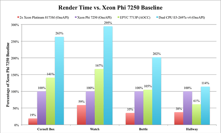

Then there are certain pieces of software, like Substance Painter or Mitsuba Render 2 (results below) that make serious use of AVX512, which tell a much different story, but those are obviously outliers:

You have to consider the nature of the main application. The render example above is known to be highly optimized for intel architecture.
