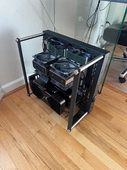

Wendell, where did you get that open air case? I need one myself but having a hard time finding a decent open case. That is a beast of a setup, I thought my setup was a monster, lol
For your awareness, this setting simply prioritizes SOC over cores when running up against a processor power budget limit. If you’ve enabled PBO advanced on this board and unlocked to board limits this will never be a concern. High Performance Mode (prioritizes cores over SOC) and Maximum I/O Performance Mode will be the same in all regards.
Glad to hear you worked this out.
@UserX Have you given any thought to the case @JayVenturi used in his thread The Zen of Air Cooling. The Zen of Air Cooling.

I like this case, I will have to look into it.

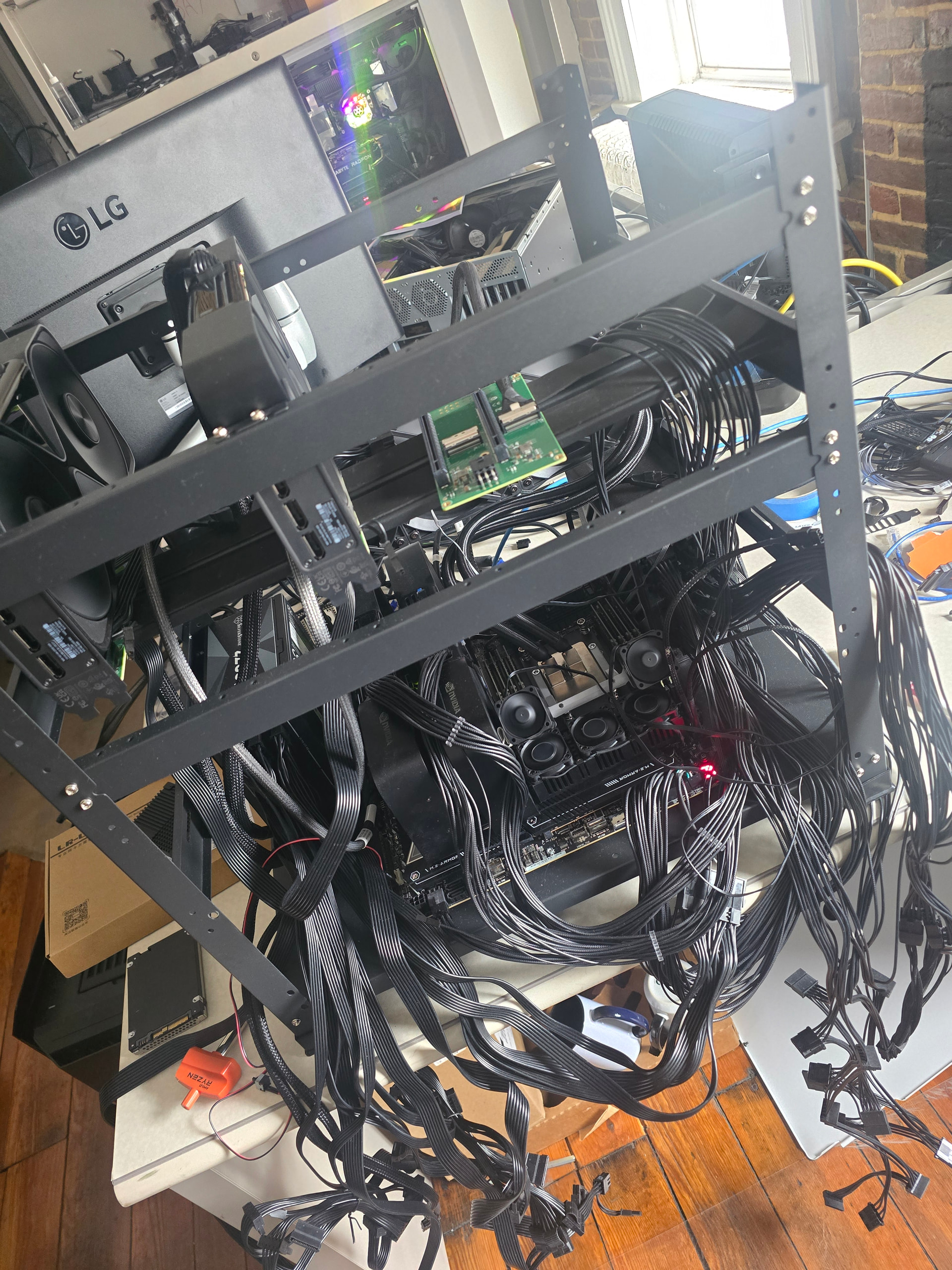

I’m having what looks like a similar issue also happen to be on a dual PSU. I have 6 GPUs running on mine so a single PSU isn’t an option. Presently i have two silverstone 2500. My issue arrives more often than not after long periods of down time and during hard ramp ups from a prompt. I have a cronjob that occurs at 0400 when nothing is really going on in the house and everyone is asleep and this has triggered it at least a few times.
The system can run fine for over a week, but has suffered multiple complete platform hard-freezes with no useful final logs. No Xid, no AER fatal, no MCE, no panic, no kdump/vmcore. The machine simply stops responding and requires a physical reset.
The crashes seem correlated with multi-GPU llama.cpp workloads after the GPUs have been idle long enough for the PCIe links to downshift though I think i’ve seen it occur at the point of a downshift too, not just an upshift.
I’ve put a ton of effort into tracking this down and im about 99% sure its occurring when the cards negotiate from PCI 1 to 5 and or 5 back to 1. Im now testing if it occurs while i’m in PCI 4.
System
  • Motherboard: ASUS Pro WS WRX90E-SAGE SE
  • CPU: Threadripper Pro 9975WX
  • RAM: 192 GB DDR5 RDIMM ECC
  • GPUs:
    • 5× NVIDIA RTX PRO 6000 Blackwell Max-Q Workstation Edition, 96 GB each
    • 1× RTX 5090, 32 GB
  • OS: Ubuntu 26.04
  • Kernel: 7.0.x series
  • NVIDIA driver: 595.71.05
  • CUDA: 13.2
  • Main workload: llama.cpp / llama-server, OpenAI-compatible API, Hermes/Open WebUI style agent workloads
  • Main model service uses the 5× Pro 6000s; 5090 is used as a sidecar GPU
  • Board currently boots all six GPUs successfully
