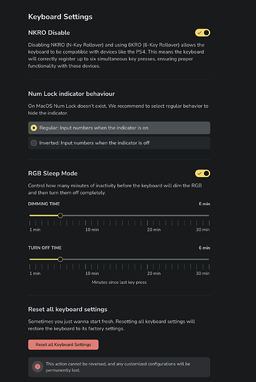

So I have now a Wooting 80HE and it only works if I disable NKRO for the keyboard. And the wooting keyboard siwtches from uses the “old style 6 key max” enpoint to using ONLY the new NKRO rollover keyboard endpoint
My previous Steelseries Apex instead did trickery achieve the NKEY rollover but haivng both endpoints, sending the first 6 key strokes on the “old” endpoint and only using the new endpoint for any keystroke over 6. My feeling is that the KVM switch just is not able to the parse the messages from the new endpoint.
I confirmed this behaviour by looking at usbhid-dump -e all
Interesting! Thank you for sharing your data point!
WRT To disabling NKRO, you’re are you just doing that in wootility > settings > NKRO disable?
I’ve tried that for my 60HE and didn’t get any luck.
Or is there another approach you’d recommend to disable NKRO?

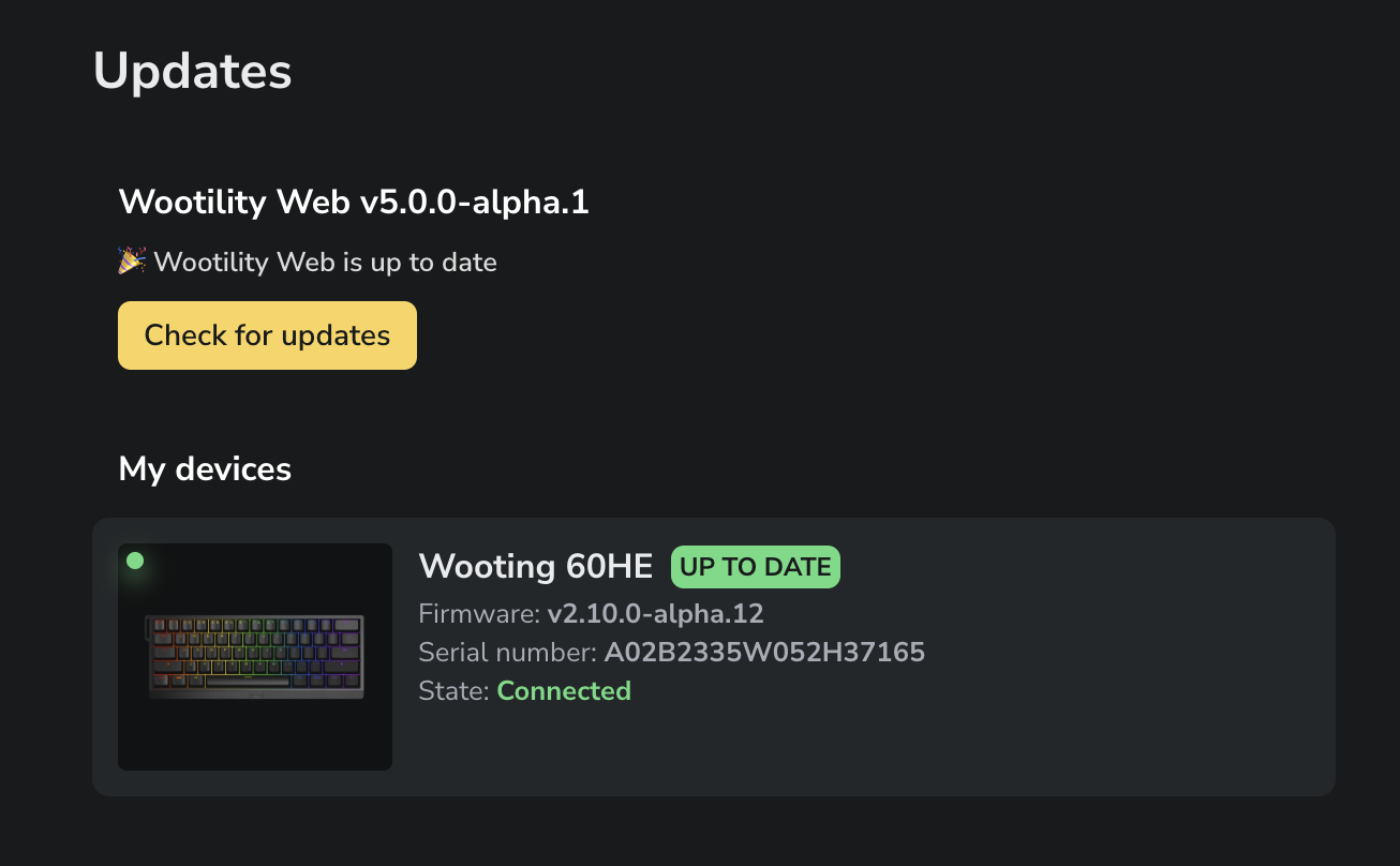

Looks like mine is
Device Name: Wooting 60HE (ARM)
Vendor ID: 0x31e3, Product ID: 0x1312
Yeah, this is the ARM model. Please update via the Wootility V5 (Wootility Web with dev flag) to get the latest alpha firmware. This has some keyboard interface changes. Then it should work when NKRO is disabled. For now I can’t say what the issue is with the current stable firmware.
I’ll give it another try.

We noticed that some systems have issues if the keyboard interface isn’t the first one and that this is the reason why for some the lock indications don’t work in the boot protocol mode. There is a dev build v2.10.0-test.itf.restructure for the Wootility v5 (Wootility Web with dev flag). So this may also helps for the KVM.
Edit on 23.02.25: Updated the link…
Just jumping in here as I have a Wooting 60HE+ and the Level 1 4 port KM switch.
I’ve tried all of the dev builds in this thread, the latest being v2.10.0-test.itf.restructure, and still when plugging the keyboard into the HID ports on the switch, I’m getting nothing. No lights or functionality at all. Still works in the non-hid USB ports just fine though. Just fine meaning it works, but I still can’t control the switch with it, to be clear.
Figured I would report in given I was able to test these!
