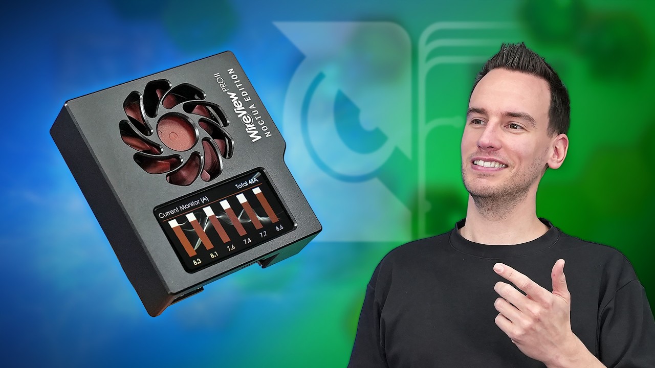

WireView Pro II GPU - A 12VHPWR per pin power monitor that can help prevent nvidia fires
Came across this device that monitors power per pin on a 12VHPWR connection that can let you know if load is not being distributed evenly. Kinda expensive, but I suppose if you have a $5000 GPU you probably won’t blink.
What’s interesting to me is that so far, supposedly 98% of problems are resolved by reconnecting or replacing the cable, and 2% are from the device itself having an issue. No problems that needed the GPU or PSU replaced have come up so far.
