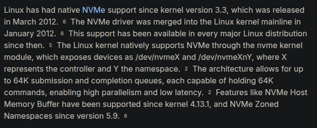

linux has had native nvme for along time

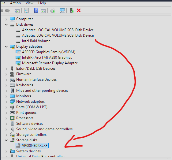

Also reverts back if you add another nvme. Ill wait for an official release.

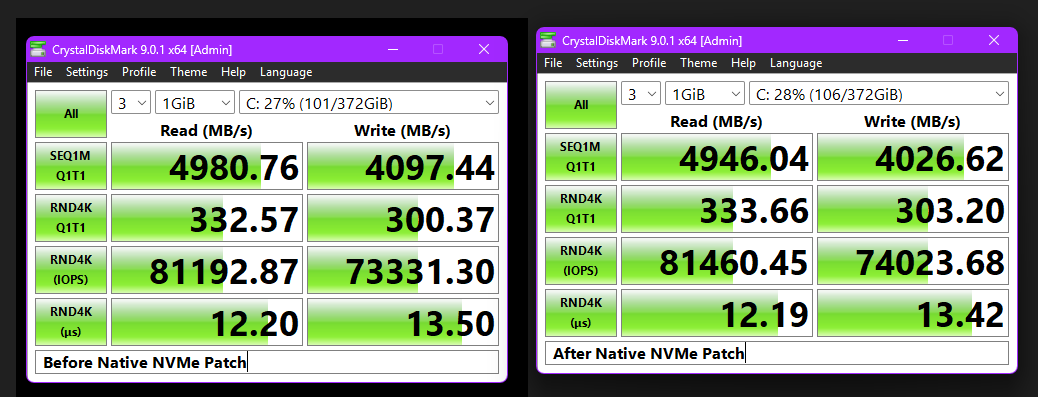

Seems pretty margin of error?
FFXIV Dawntrail loading times went from 7.51s to 7.17/7.13s.
200 points higher in 3DMark Storage. The last test was 7% faster pre-patch. The rest were 3-9% faster post-patch.

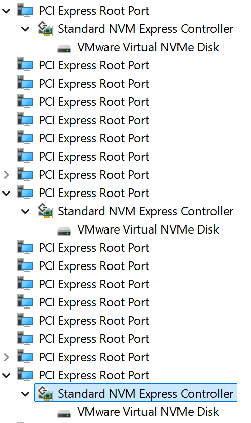

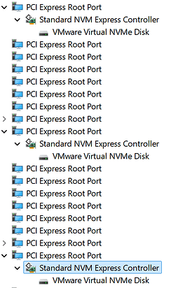

I’ve added the keys, flipped one pvscsi drive over to NVMe, ran a test, then flipped the other two drives over to NVMe. I didn’t have to re-add the keys – they’re still in my registry. Devices by connection:
All three NVMe controllers are using stornvme.sys as outlined in the articles. At the Windows level I just added the keys and rebooted.
With my Windows 11 25H2 guest beating up the host’s Linux page cache I see no benefit at Q1T1 nor with big block sequential I/O. But with DiskSPD.exe at 6 threads and a deep queue depth (32/64/128 etc) I’m seeing roughly double the 4k random read IOPs as the original setup with pvscsi. I’ve never seen a VMware Workstation guest approach 100k IOPS before but here we are.
