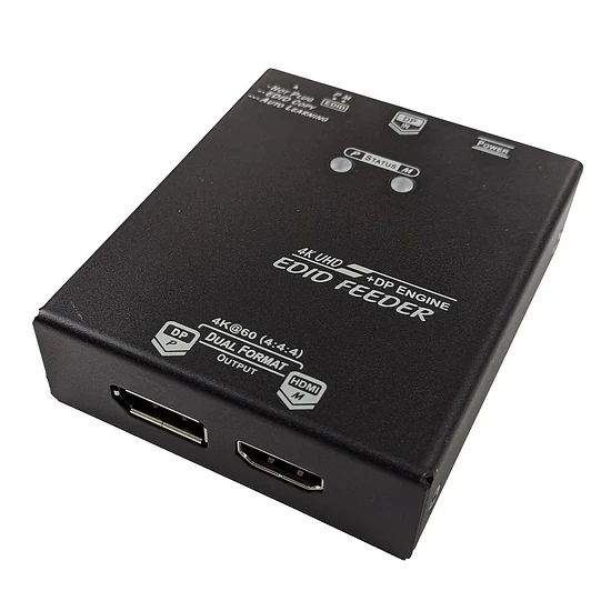

An EDID emulator is specifically designed to solve this problem by making the GPU think the monitor is always connected, thus preventing the teardown.
You want this enabled rather than disabled.
Yes, this is expected. What you are wanting is monitor emulation. Here’s a blub from the store:
This KVM does not support monitor emulation
Monitor emulation makes sure the input has an exact copy of the display’s EDID (Extended Display Identification Data) even when disconnected. Being that this KVM does not have monitor emulation, when switching between desktops, your monitor and KVM will re-handshake. AKA the windows will shuffle unless you have a software or hardware solution.
You need either a physical EDID feeder, which DisplayPort EDID is currently limited to DisplayPort 1.2 (4k/60Hz)
or a software EDID solution. The “Remember window locations based on monitor connection” enabled and “Minimize windows when monitor is disconnected” disabled usually works from what I understand
