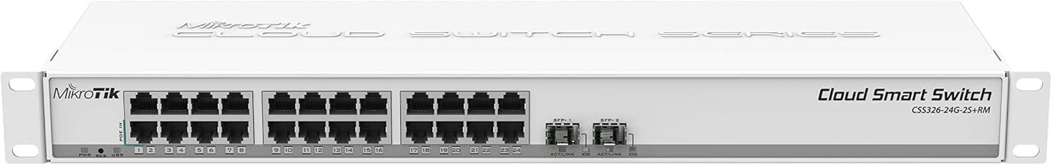

I ordered a couple Microtik managed switches to do the VLANs — one with lots of 24 x 1Gb ports and 2 x 10Gb ports, and one with 8 x 10Gb SPF+ posts — so I was not planning to do VLANs in the router.
