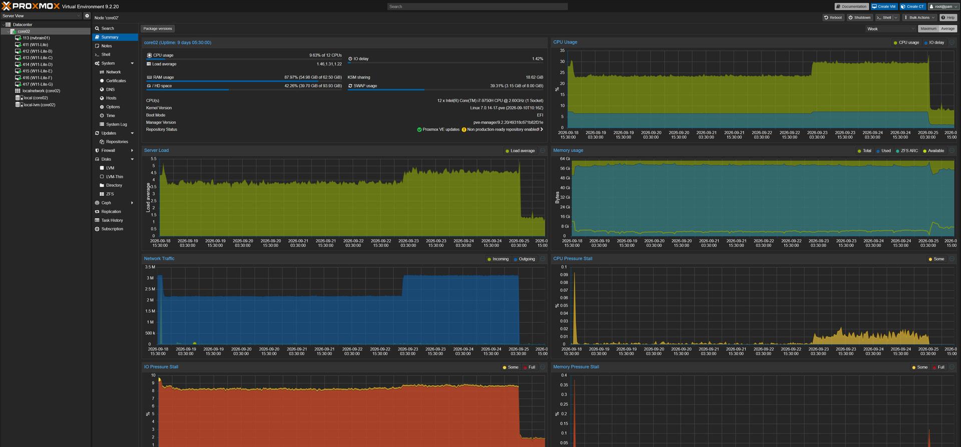

Six cores, twelve threads you say?

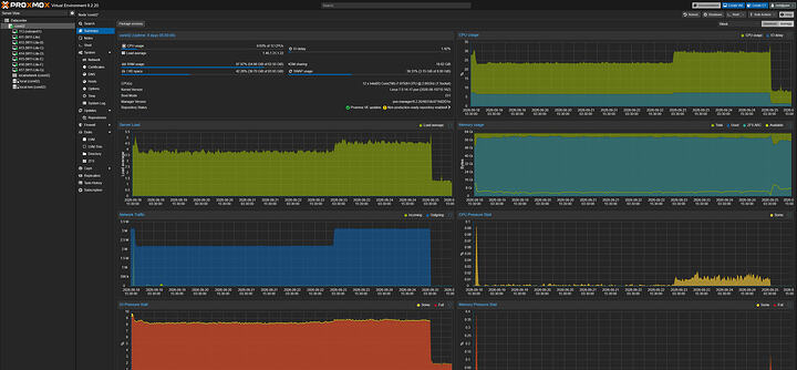

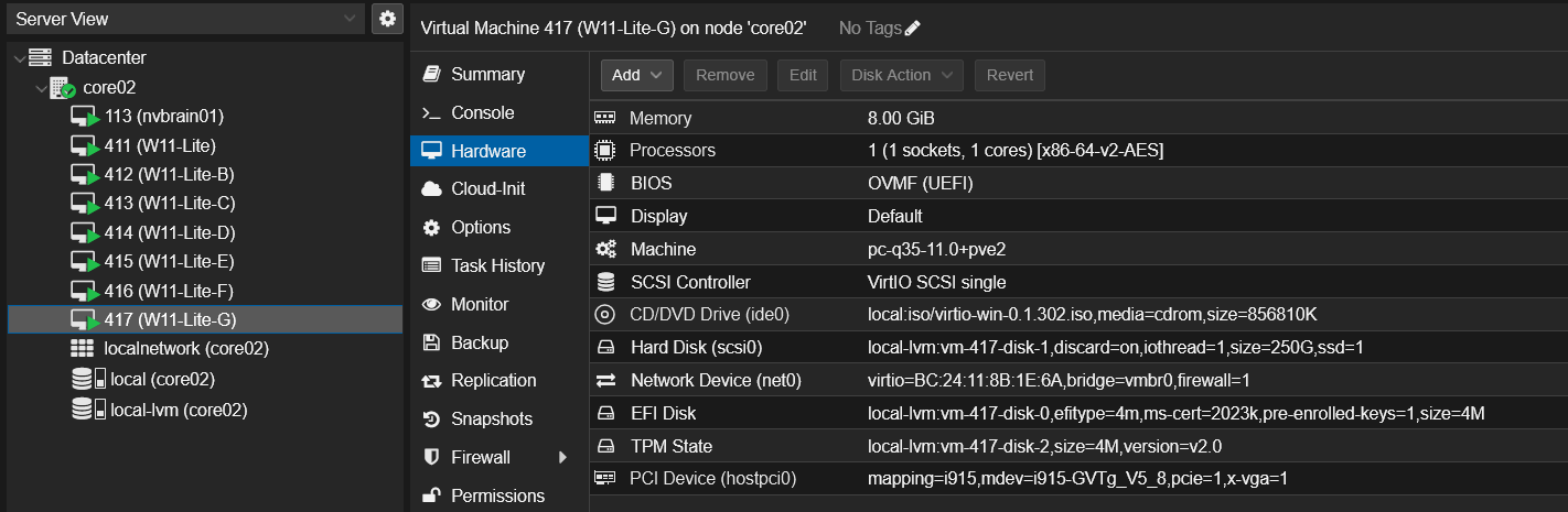

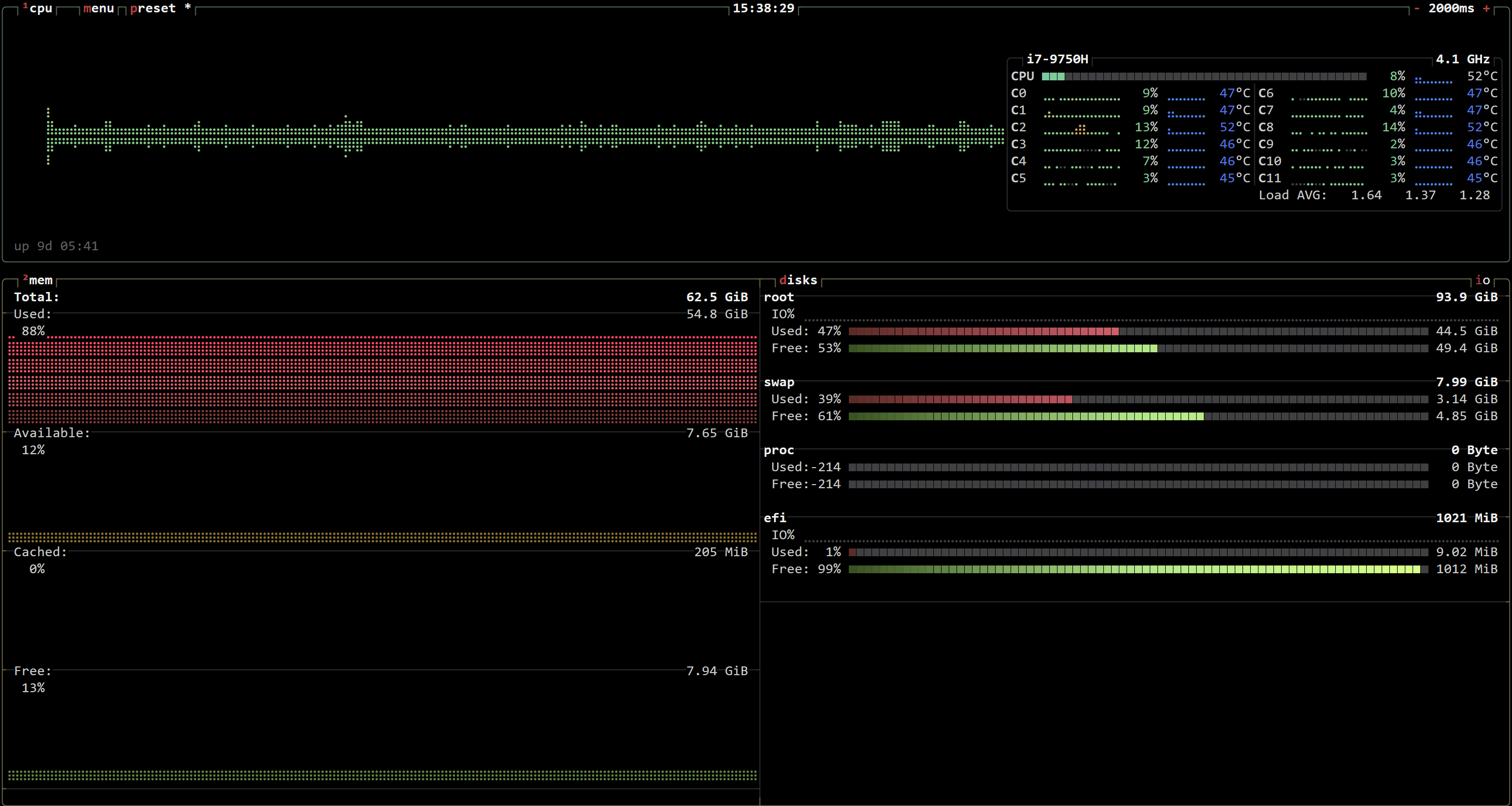

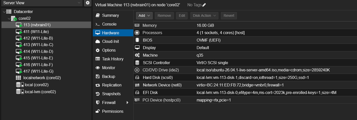

Here’s a little experiment I’ve had running for over a week on a i7-9750H, 6 cores, 12 threads. The CPU is about four years older than your AMD. Oh, and 64Gb DDR4 3200.
It’s hosting a VM with 16gb, 4 (host) cores and a RTX A2000 12Gb passed through to Ubuntu 26.04 and llama.cpp .. and then seven more VM’s of Win11 Enterprise IoT with 8gb, single core, and the i915 iGPU split (mdev) into seven (one per VM) running the Heaven benchmark.
Eight VMs total.
I can’t speak to your power envelope and usage case, but the raw bones will likely get it done.
That is pretty cool!
