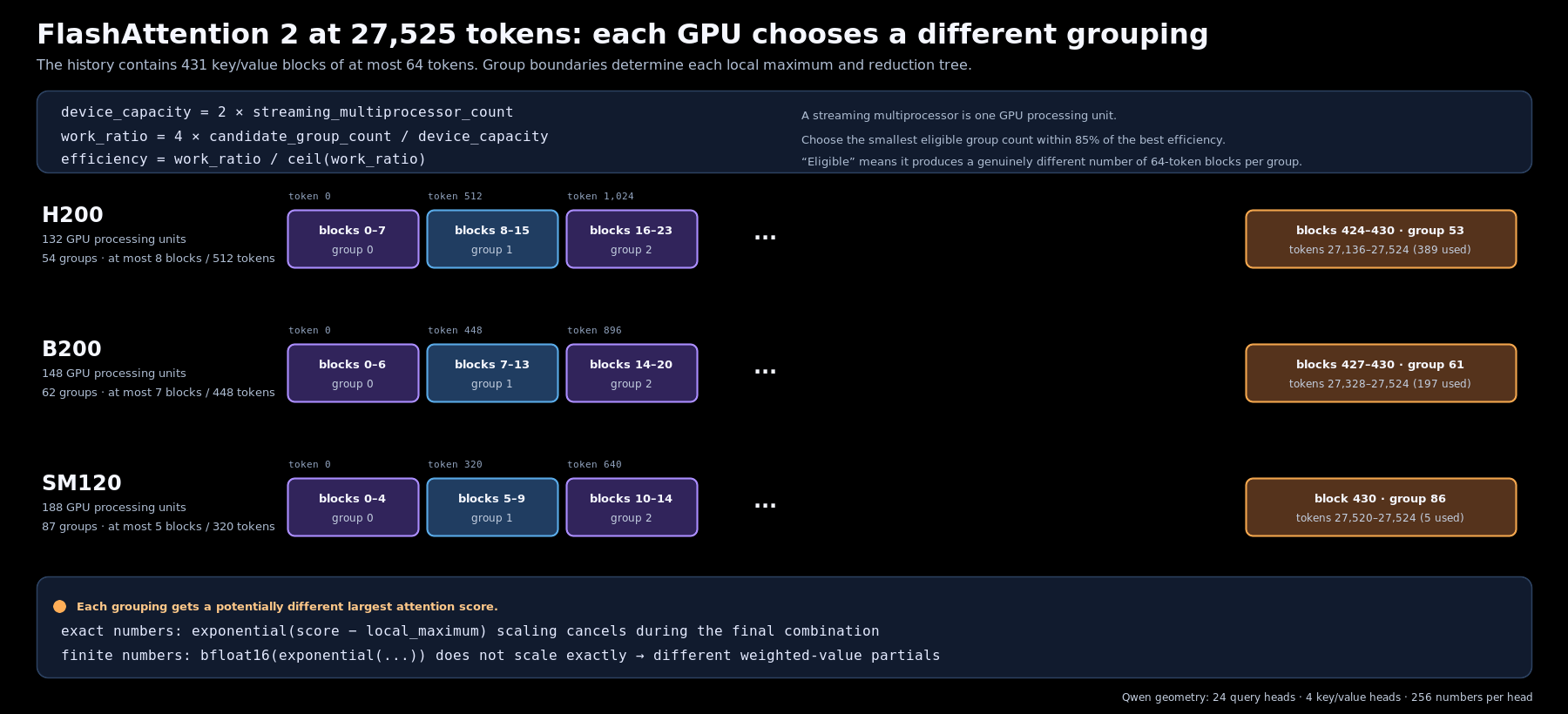

There are three available full attention backends to select from in vllm for this workload: FlashAttention 2, Flash Inference, and Triton Attention. This was the only change made between executions, the rest of the hardware and software stack remained stable.
I also performed a same-backend cross-GPU repeatability control. For this graph, I captured the full-vocabulary logits in BF16 every 32 prompt tokens. Distribution comparisons such as KLD were calculated afterward in FP64 from those stored logits.
Top-1 agreement is whether the token with the highest logit, the greedy argmax, was the same. All three backends were evaluated against the same forced token history. A “top-1 flip” therefore means a backend would have chosen a different greedy next token at that position. We did not let that choice alter the remaining history. This keeps the mathematical comparison controlled, but it does not show how far an unconstrained generation would branch or whether a tool call would eventually fail… that comes in test 2 ;D

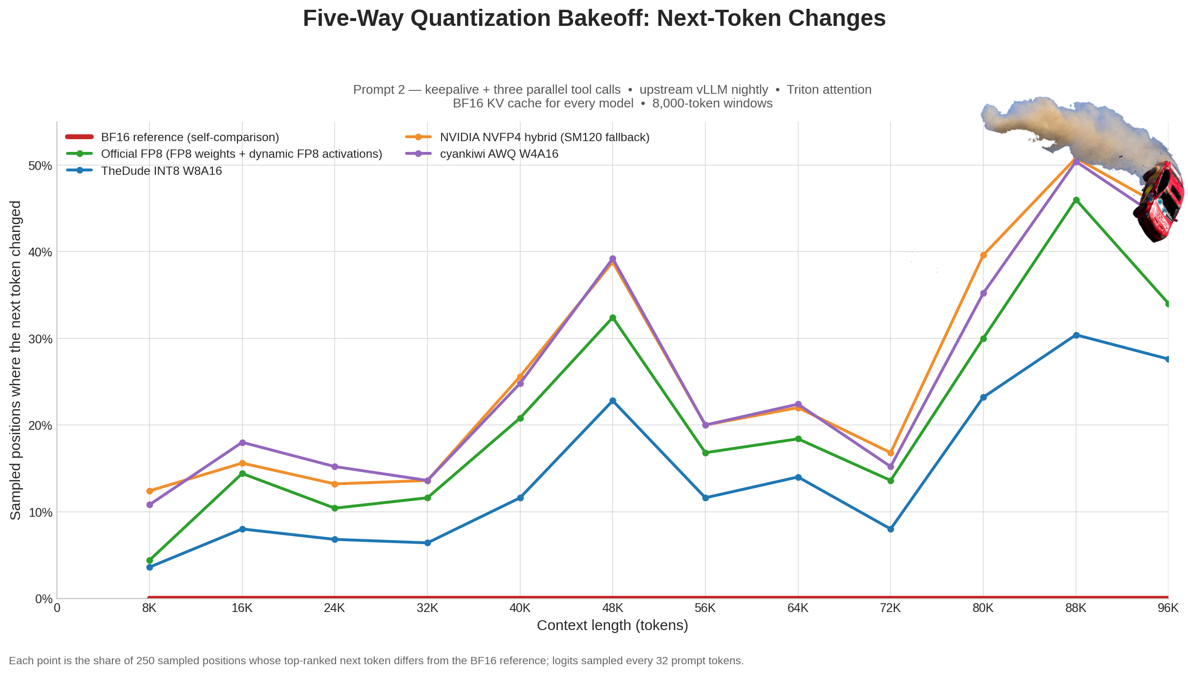

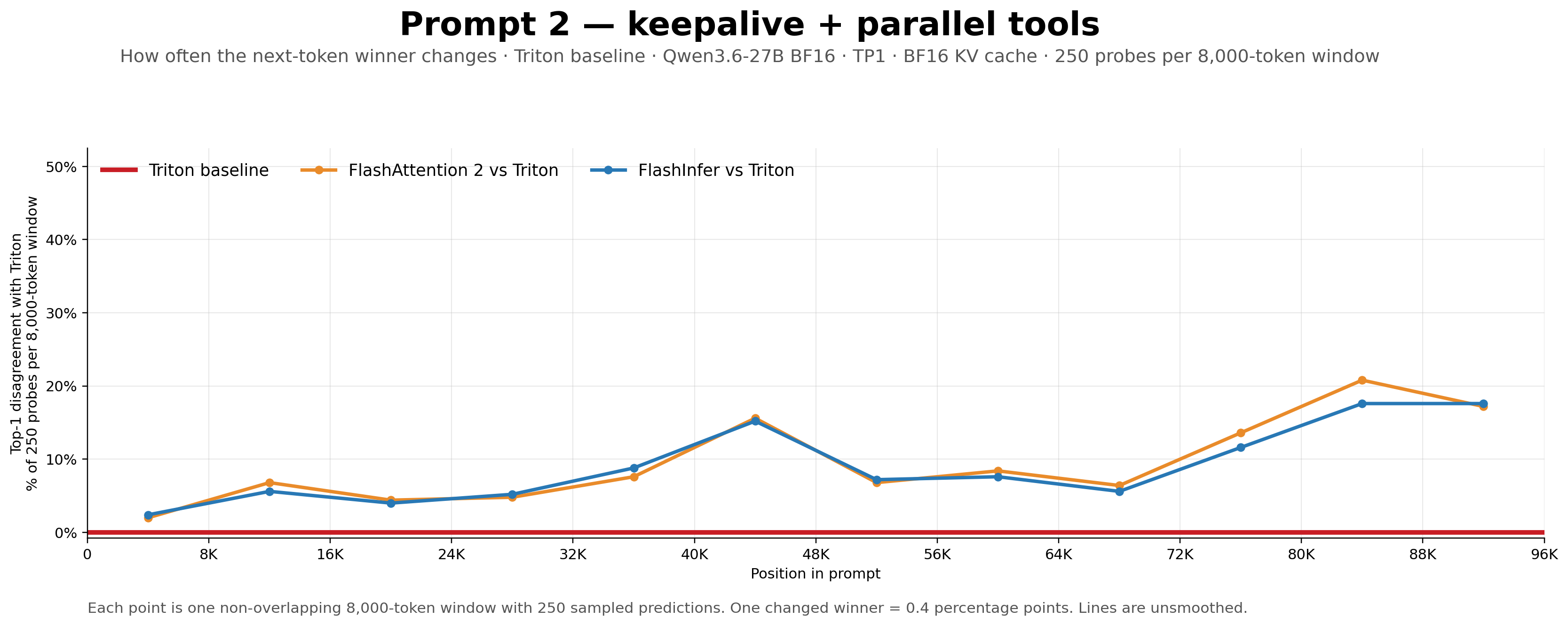

The following graph shows % of sampled logits resulting in token flips:
For the first several thousand tokens, every run of the model agreed about what the next token was going to be regardless of backend. Then in later portions of the prompt, backends began disagreeing. Triton was selected as the baseline to simplify upcoming quantization chicanery.
Each 8k-token window contains 250 sampled positions, one probe every 32 tokens. The percentage is the fraction of those probes where the other backends highest-scoring token differed from Triton’s.
Random noise was accounted for by running the same test with the same attention backend multiple times. The logits across runs at every hidden state were bit for bit identical. Meaning this particular divergence comes exclusively from the matrix multiplication and addition operations happening during prefill inside trt/fa2/fi.
Disagreements appeared in clusters and varied with prompt content rather than increasing smoothly with context length. This is not evidence of one universal length at which the model “falls apart” but… we will get there soon

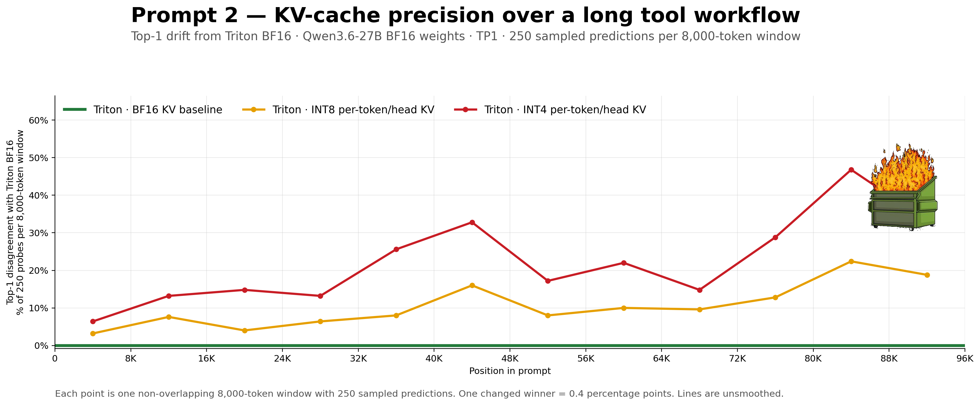

Test 2: KV Cache quantization, or why your LLM’s IQ drops like a rock after 40k tokens
Repeating the same methodology, we took the BF16 weights and BF16 kv cache baseline above running Triton, and ran the next experiment. What happens when you leave the weights and activations alone, and JUST quantize the kv-cache?
Ah, divergence. And this leads us to our first dumpster-fire of the evening: a completely reproducible tool calling error.
Enough top-tokens got flipped during tool calls, we let them play out and while BF16 was fine, int8 kv-cache eventually managed to recover, int4 did not!

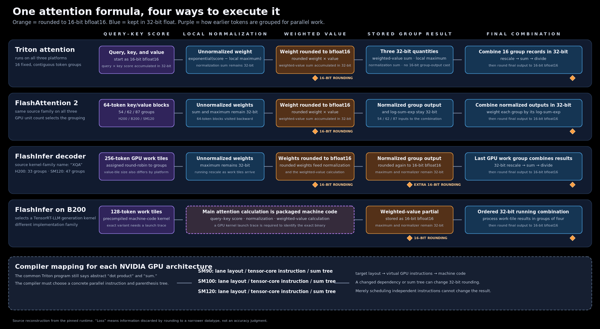

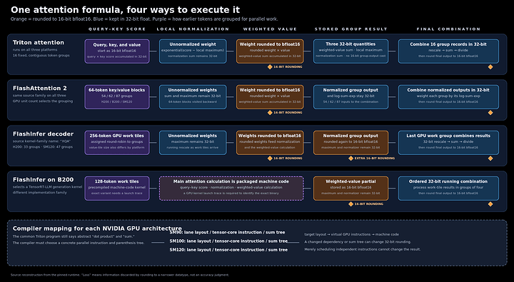

Low level cuda kernel and NCCL path differences, driver differences, vllm container runtimes, different GPUs, different combinations of multiple GPUs, attention runtimes, different caching, different model quantizations, and in fact… even different models. 3.6 vs 3.8 anyone?

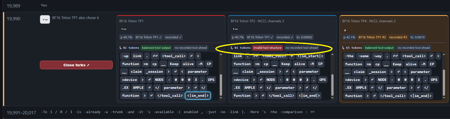

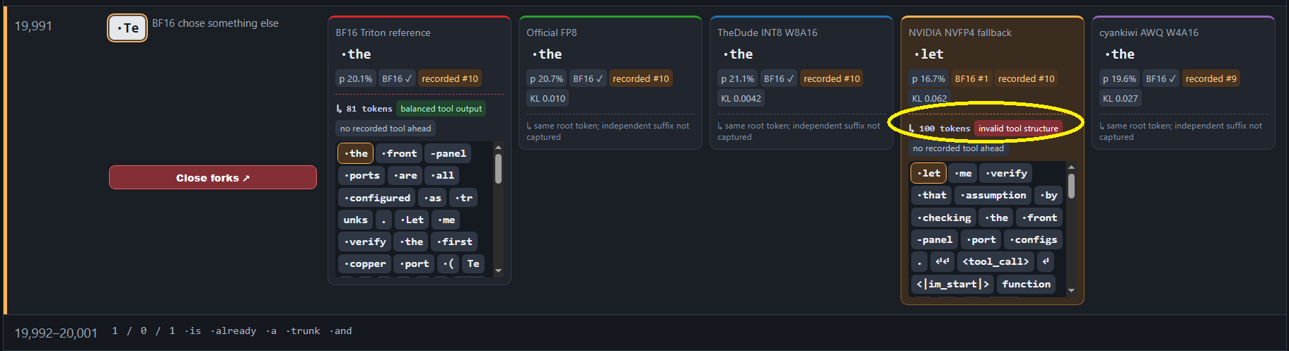

Lets go all the way down to unstructured tensor space, see a real failed tool call, a token flip caused by the difference in attention back end / cuda kernel:

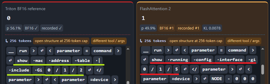

In this example of a single token flip, the model executes a tool call targeting an interface on a Cisco router: GigabitEthernet0/0/1.201
Flash attention 2 gets it wrong. It targets GigabitEthernet0/1/4 instead.
Then, it runs the wrong command AGAIN in two diverging tool calls:
The correct command (trying to find the owner of a mac address) is show mac address table. FA2 tries to show run its way out of the mess that token flip has gotten it into.
In this next example, the LLM tried to configure a description on an interface. The FA2 token flip failed to execute that task at all.
Remember. this is simply changing one configuration option in VLLM to select TRT/FA2/FI. Same gpu, same os/drivers/software/vllm/prompt/cache/weights/activations… And this is REPEATABLE between runs, bit-identical logit captures!
If a simple runtime difference in cuda kernels caused this to happen in production, it could result in a critical network outage. The positioning is so impressively bad I could not have hoped for a better example of why precision measurement and testing matters!
Enter the Tensorverse!
We see token flips in many scenarios. This is comparing Tensor Parallelism vs single GPU:
At TP1 we get an acceptable tool call, at TP2 it fails, at TP4 it succeeds again. WTF?! (This is USUALLY NCCL’s fault when you debug even further and capture the nccl graphs…)
Across the 5-weight quant-off from the weekend:
We have BF16, FP8, INT8, and W4A16 all getting it right. Only NVFP4 fails this tool call >_>

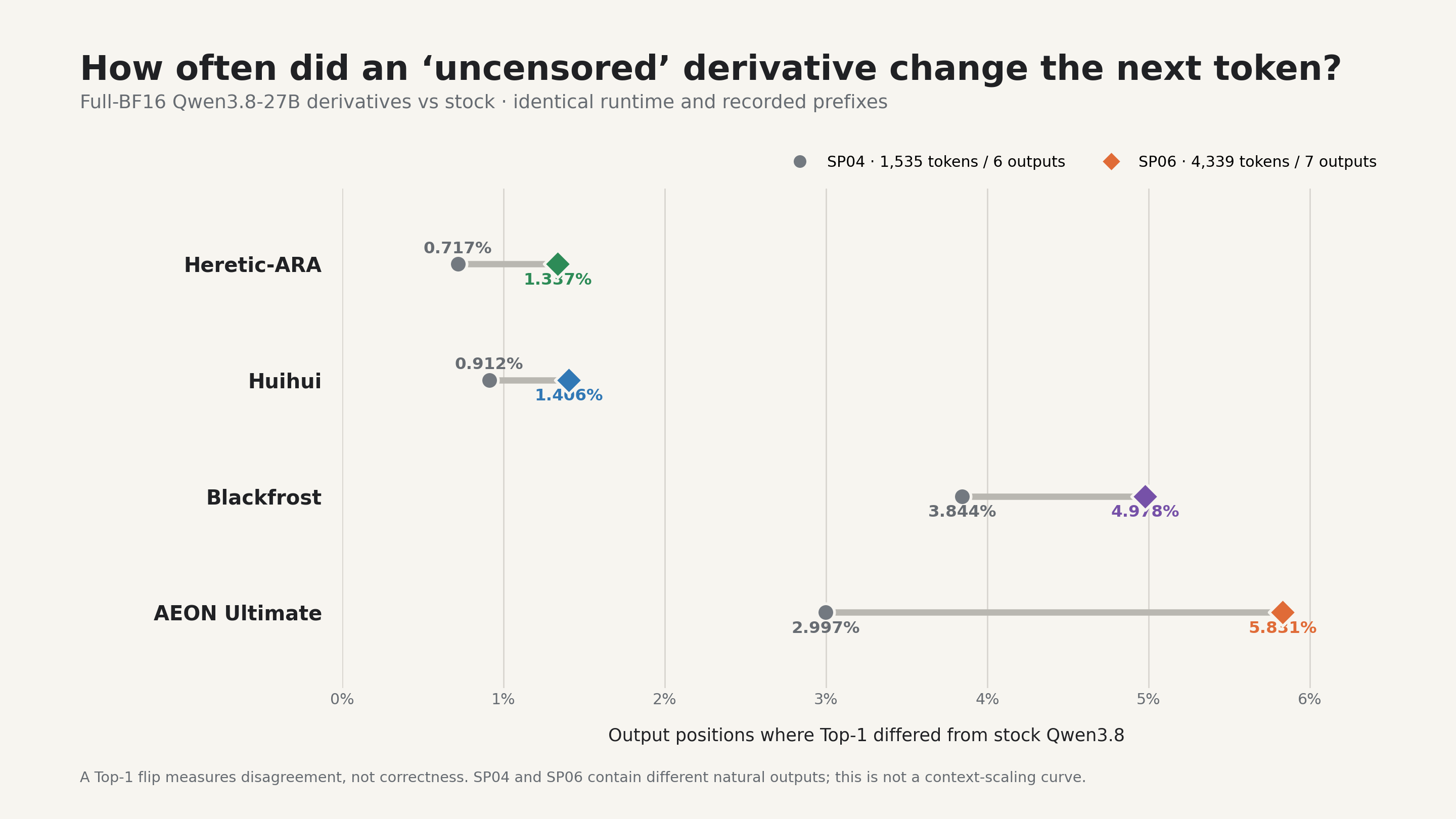

Derivative vs stock Qwen3.8 Method SP04 Top-1 flips SP06 Top-1 flips SP06 worst-range p95 KLD Invalid branch futures, SP04 / SP06
Heretic-ARA Reproducible ARA ablation 0.717% 1.337% 0.03661 0/11 · 0/58
Huihui Abliterated “Crude proof-of-concept” abliteration 0.912% 1.406% 0.04477 0/14 · 0/61
Blackfrost Abliterated Refusal-direction weight edit 3.844% 4.978% 0.31235 0/59 · 1/216
AEON Ultimate SSM repair + Abliterix + MTP graft 2.997% 5.831% 0.68507 8/46 · 36/253
The first two quants appear remarkably functional while the latter two should probably go on the do-not-use list.
SP04 covers 1,535 assistant-output tokens in six natural ranges. SP06 covers 4,339 tokens in seven ranges, including prose, exact CLI/SQL/code, multi-tool calls, recovery actions, and architecture recommendations.
“Invalid branch futures” means structurally invalid output among the specifically selected Top-1 divergence roots we explored. It is not a general tool-call failure rate, and adjacent roots can expose the same underlying failure.
Broadly across all testing this week, top 1 token flips appear to be quite tied to the actual specific workstream being captured. Some tasks are very low <1% diff, others spike up wildly between different configs/quants/etc. This is something I need to go into more in a later future post.

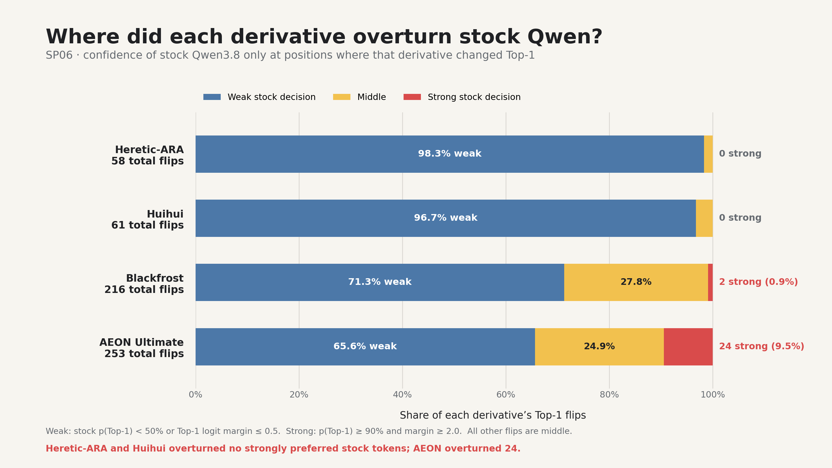

Heretic-ARA
On SP06, 57 of its 58 flips occurred where stock Qwen was already uncertain. It overturned zero strongly preferred stock tokens.
Its method is also the most reproducible:
  • Targets attn.o_proj and mlp.down_proj.
  • Uses Arbitrary-Rank Ablation.
  • Discloses datasets, seed, search settings, and 60 search trials.
  • Reports its refusal and base-KL selection criteria.
This is the strongest example of an ablation that changed the target behavior without broadly destabilizing ordinary technical output.
The crude Huihui treatment also worked surprisingly well
Huihui explicitly labels its process a crude proof of concept, yet it landed in almost the same conservative tier as Heretic-ARA:
  • 1.406% flips on SP06.
  • 59 of 61 flips occurred at weak stock decisions.
  • No objectively invalid structured branches in either prompt.
That is probably the biggest positive surprise. A sophisticated procedure was not required to preserve this particular technical workload, but that does not establish equal refusal removal or general quality.
Blackfrost changed much more, but usually remained coherent
AEON was the most disruptive on SP06:
  • 5.831% Top-1 flips.
  • Highest worst-range p95 KLD.
  • 24 flips overturned strongly preferred stock decisions.
  • 36 structurally invalid SP06 branch futures.
  • All eight SP04 invalid futures were AEON.
This is not a clean “abliteration is bad” result. AEON combines:
  1. SSM conv1d outlier repair.
  2. An Abliterix search.
  3. A stock MTP graft.
Its card says the selected trial prioritized coherence rather than minimum KL. Therefore, the experiment measures that complete recipe, not abliteration alone.
The most compelling failure example… AEON
AEON at SP06 token position 42,950 is nearly perfect for a visual explainer.
  • The context contained PostgreSQL port 5432.
  • Stock selected the final 2 with probability 0.9991.
  • AEON selected ql with probability 0.9158.
  • The alternate continuation produced 543ql.
  • It subsequently failed to close the tool/function envelope.
A second nearby case corrupted a known hostname:
  • Stock selected enant in .tenant with probability 0.99996.
  • AEON selected - with probability 0.99747.
  • The resulting branch altered the hostname and later damaged a parameter.
These are not vague stylistic differences. They are high-confidence literal-copy failures in operational commands.
Another useful example changed psycopg’s page_size=100 into size=100, likely turning a valid API argument into an invalid one.
Vision and MTP weights were untouched
We independently hashed every logical vision and MTP tensor against stock, even where checkpoint sharding differed:
  • 333/333 vision tensors matched exactly.
  • 15/15 MTP tensors matched exactly.
  • Roughly 1.77 GB of tensors per checkpoint were checked.
All four derivatives preserved them byte-for-byte. Therefore, the text results come from language-weight changes rather than hidden vision or MTP modifications.
It does not prove identical vision behavior, the panel did not activate the vision path but it establishes exact weight preservation.
Confidence
When Qwen was LESS confident about the next token is where we saw the most flips overall. However when Qwen was confident, the faithful among blasphemers did not flip their results.
Only the truly heretical overruled Qwen’s strong next token signal for their own, resulting in errors.
On these long-context technical workloads, Heretic-ARA and Huihui preserved stock behavior far better than Blackfrost and AEON. AEON produced the clearest reproducible operational damage, but its bundled recipe prevents attributing that damage solely to abliteration. None of these measurements establishes which derivative is most successfully uncensored.
Refusal benchmarks and model-card KLD numbers do not characterize collateral changes to tool use, exact literals, code, or long-context agentic work.

Note how there are no units to this picture. It is not an absolute view of how different things are. It is all relative. How different is flash attention 2 on an SM120 vs B200 vs H200? Draw a triangle. How different is flash attention 2 from flash inference from triton attention on a single H200 card? Draw another triangle. By interconnecting the triangles we get a 3d region. And now we can plot the relative difference everyone is from the center of that region. So, who is closest to the center?
This result is rather interesting for several reasons I will get into. Obviously the calculations are prompt specific so I used the widest selection of data across many context depths to calculate the divergence.

In our case, we are testing 3 different pluggable attention backends. FA2, FI, and TRT.
The model inputs, weights, key/value cache, and output logits used bfloat16, a 16-bit floating-point format that keeps a wide numerical range but substantially less precision than 32-bit float.
Each hardware/software coordinate was highly repeatable. H200 results were byte-identical across two providers, while B200 and local SM120 repeats were also byte-identical. The differences therefore look like stable consequences of different arithmetic programs, not random run-to-run noise.
The usual disclaimer for oversimplification applies.
The orange boxes in the figure are places where a 32-bit number is rounded to 16-bit bfloat16. Blue boxes retain 32-bit state. Purple boxes show how the input tokens are divided into parallel work groups.

Why FlashAttention 2 selects 54, 62, or 87 groups
FlashAttention 2 operates on 64-token key/value blocks in this Qwen decode. At 27,525 tokens, the number of blocks is:
\text{key value block count} = \left\lceil\frac{27{,}525}{64}\right\rceil =431.
A streaming multiprocessor is one of the GPU’s parallel processing units. H200 has 132, B200 has 148, and the tested SM120 card has 188. The pinned FlashAttention 2 heuristic estimates device capacity as:
\text{device capacity} = 2\times\text{streaming multiprocessor count}.
Qwen has four key/value heads after its grouped-query reshape, so a candidate split count is scored using:
\text{work ratio} = \frac{4\times\text{candidate split count}} {\text{device capacity}},
\text{estimated efficiency} = \frac{\text{work ratio}}{\lceil\text{work ratio}\rceil}.
The source chooses the smallest eligible split count whose estimated efficiency is at least 85% of the best candidate. This gives:
Platform GPU processing units Chosen groups 64-token blocks per group Maximum normal group span
H200 132 54 8 512 tokens
B200 148 62 7 448 tokens
SM120 188 87 5 320 tokens
The H200 boundaries begin at tokens 0, 512, 1,024, and so on. B200 boundaries begin at 0, 448, 896. SM120 boundaries begin at 0, 320, 640. Consequently, the same token is normalized alongside different neighboring tokens on each GPU.
Plugging in actual numbers
The accompanying Python program creates a deterministic 27,525-token teaching
input. These are synthetic scores and values, not captured Qwen activations, but
the program uses the real 64-token blocks and the real 54/62/87 split counts.
The ideal real-number output for that input is
\text{exact real number output}=1.325056137248.
The scalar FlashAttention-2-like calculation produces:
Platform Split count First group size First local maximum 32-bit output before final rounding Final bfloat16 output
H200 54 512 tokens 1.875 1.3241630793 1.3203125
B200 62 448 tokens 1.750 1.3242336512 1.3281250
SM120 87 320 tokens 1.500 1.3242592812 1.3281250
Only the platform-selected grouping changed in this FlashAttention 2 example. The H200 result falls on one bfloat16 value, while the B200 and SM120 results round to the next value. This example is deliberately chosen to expose the boundary and does not imply that one split count is generally more accurate.

def choose_flash_attention_two_split_count(
    total_token_count: int,
    streaming_multiprocessor_count: int,
) -> tuple[int, int, int]:
    """Implement the pinned FlashAttention 2 split-count heuristic.
    Qwen has four key/value heads after its grouped-query reshape. The FA2
    source treats each streaming multiprocessor as capacity for two of these
    128-thread work blocks.
    key_value_block_count = math.ceil(
        total_token_count / TOKENS_PER_FLASH_ATTENTION_BLOCK
    effective_device_capacity = 2 * streaming_multiprocessor_count
    workers_before_splitting = 4
    largest_candidate = min(128, effective_device_capacity, key_value_block_count)
    eligible_candidates: list[tuple[int, float]] = []
    for candidate_split_count in range(1, largest_candidate + 1):
        changes_blocks_per_split = candidate_split_count == 1 or math.ceil(
            key_value_block_count / candidate_split_count
        ) != math.ceil(key_value_block_count / (candidate_split_count - 1))
        if not changes_blocks_per_split:
            continue
        wave_count = (
            * candidate_split_count
            / effective_device_capacity
        estimated_efficiency = wave_count / math.ceil(wave_count)
        eligible_candidates.append((candidate_split_count, estimated_efficiency))
    best_efficiency = max(efficiency for _, efficiency in eligible_candidates)
    selected_split_count = next(
        candidate
        for candidate, efficiency in eligible_candidates
        if efficiency >= 0.85 * best_efficiency
    blocks_per_split = math.ceil(key_value_block_count / selected_split_count)
    return selected_split_count, key_value_block_count, blocks_per_split

def make_flash_attention_two_partitions(
    split_count: int,
) -> list[list[int]]:
    """FA2: contiguous 64-token blocks, visited backward inside each split."""
    block_count = math.ceil(total_token_count / TOKENS_PER_FLASH_ATTENTION_BLOCK)
    blocks_per_split = math.ceil(block_count / split_count)
    partitions: list[list[int]] = []
    for split_number in range(split_count):
        first_block = split_number * blocks_per_split
        one_past_last_block = min(first_block + blocks_per_split, block_count)
        token_indices: list[int] = []
        for block_number in range(one_past_last_block - 1, first_block - 1, -1):
            first_token = block_number * TOKENS_PER_FLASH_ATTENTION_BLOCK
            one_past_last_token = min(
                first_token + TOKENS_PER_FLASH_ATTENTION_BLOCK,
                total_token_count,
            token_indices.extend(range(first_token, one_past_last_token))
        if token_indices:
            partitions.append(token_indices)
    return partitions

Backend names expand into four decode algorithms
The scored SP06 workload is 99.84% one-token-at-a-time decode, so the decode algorithms dominate the comparison.
Triton attention always uses 16 contiguous token groups. It stores the weighted-value sum, local maximum, and normalization sum as 32-bit floats, then combines at most 16 group records in a 32-bit reduction tree.
FlashAttention 2 uses contiguous 64-token blocks, but its 54/62/87 group count depends on the platform’s processing-unit count. It stores each normalized partial output and its logarithmic normalization statistic as 32-bit floats.
FlashInfer’s decoder named “XQA” runs on H200 and SM120. XQA is the source’s kernel-family name. It uses 33 round-robin groups on H200 and 47 on SM120, assigning 256-token GPU work tiles cyclically among those groups. It uses bfloat16 exponential weights for both the normalization sum and the weighted-value calculation. It also rounds every normalized group output to bfloat16 before the final combination.
FlashInfer on B200 instead selects a TensorRT-LLM generation-attention kernel. Its visible reducer consumes one bfloat16 weighted-value partial plus 32-bit maximum and normalization statistics for each 128-token work tile, then combines those partials using an ordered running recurrence. The main attention body is packaged machine code, so its internal probability rounding cannot be stated without a kernel launch trace.
GPU specific lowering in Triton
Triton source contains abstract operations such as “dot product” and “sum.” Target-specific GPU lowering is the compiler stage that maps those abstract operations to the lane layout, tensor-core instructions, shuffle operations, and reduction tree supported by a particular NVIDIA architecture:
Triton program:
  -> common compiler representations
  -> SM90, SM100, or SM120-specific layout
  -> virtual GPU instructions
  -> final machine code
The pinned Triton attention source is identical through its common LLVM compiler representation on all three platforms, but the target layouts, virtual instructions, and machine-code binaries differ.
Changing only a floating-point parenthesis tree can change a result. At 1.0, 2^{-24} is half the distance to the next float32 number:

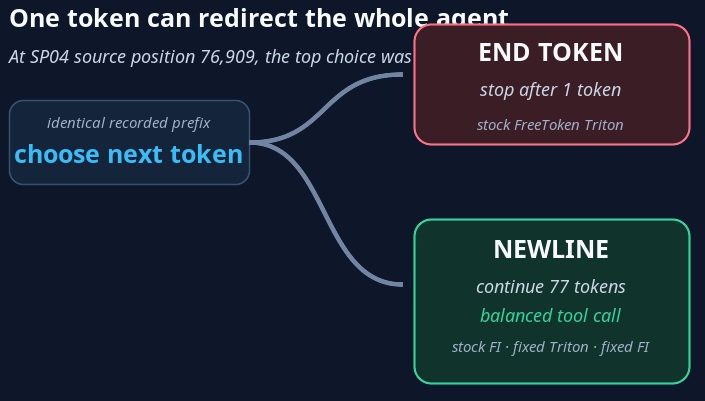

So, the Qwen3.6-35B BF16 weights running in VLLM is the same model in FreeToken, right?
TL;DR:
Calling BF16 weight-format alignment “exact precision parity” is like calling two compilers equivalent because they read the same source file.
Testing
This test is slightly different from our previous simpler direct compare of qwen 3.6 27b DENSE along changing variables. The whole freetoken engine focuses on MOE performance, so we need an MOE baseline. Thankfully, qwen 3.6 also has a 35b moe cousin we can run through the full gauntlet of teacher forced decode and full logit capture.
Qwen3.6-35B has 40 decoder layers: 30 GDN/linear-attention layers and 10 full attention layers. FreeToken’s triton versus fi switch only chooses the conventional attention implementation in those ten full-attention layers. GDN, normalization, routing, expert kernels, residuals, and the LM head remain other sources of end-logit movement.
FreeToken’s Triton attention is its own SGLang-style split-K paged kernel. It is not the pinned vLLM Triton implementation. Its fi mode explicitly invokes FlashInfer’s FA2 page-size-one path.
We replayed 9,060 identical Qwen3.6-35B decision points through vLLM and this new local inference engine. Normally at pure BF16 in replays, we see a few token flips changing attention backends… But this had some weird results… There was a bug.

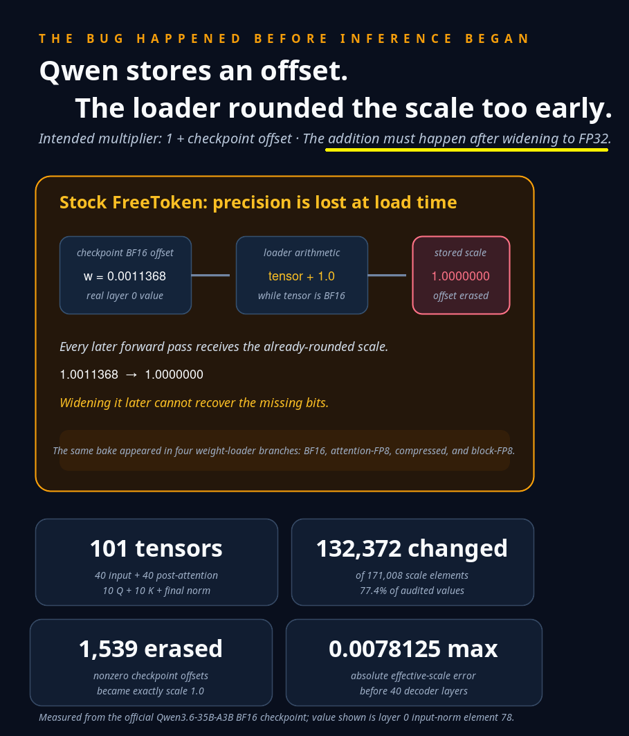

Freetoken was rounding Qwen’s normalization scales before the model ever ran
Qwen stores a centered BF16 offset w; the effective RMSNorm multiplier is 1 + w. The intended operation widens w to FP32 and then adds one at runtime.
Stock FreeToken added one in the BF16 loader and stored the already-rounded effective scale.
Actual checkpoint example from layer 0, input-norm element 78:
stored BF16 offset:       0.0011367798
intended FP32 scale:      1.0011367798
stock baked BF16 scale:   1.0000000000
The small learned offset disappears completely. Across the official model this affected 101 norm tensors; 132,372 of 171,008 scale elements changed and 1,539 nonzero offsets became exactly 1.0.
The source-level fix is short:
# stock loader
tensor = tensor + 1.0
# repaired loader/model
# preserve the checkpoint offset, then inside the norm kernel:
w = load(weight).to(float32)
w = w + 1.0
The repair changes decoder input norms, post-attention norms, ten Q norms, ten K norms, and the final norm. It does not change attention, GDN, MoE, router, LM head, or logit observer code.
Direct stock-to-repaired p99 drift is 0.0478–0.0497 and changes 93–107 greedy choices. Direct full-GPU-to-exact-20/20 placement p99 is 0.0211–0.0226 and changes 53–75 choices. In this test, fixing the loader moved the distribution about twice as much at p99 as moving half the routed-MoE layers to CPU.
This is not a universal ranking of inference effects. It is a controlled result for this checkpoint, these frozen futures, BF16, TP1/eager, and SM120.
Results of fixing the bug
That persistent upstream error is then fed through GDN recurrence and 40 routed-MoE layers. Tiny residual changes can cross a router’s top-k boundary, select a different expert, and turn the original rounding perturbation into a much larger state difference.
At SP04-M081/B00019:
Engine Next Token Result
Stock FreeToken Triton <im_end>
Repaired FreeToken Triton newline completed a 77-token balanced tool call
Wrap up
I am not calling other inference engines or their attention implementations bad. But… There is a serious lack of precision testing going on right now, and that IS demonstrably bad.
Lots of other potential testing with Freetoken remains unexplored, mostly because trying to launch FP8 weights failed and I didn’t care to dig into it any more.
SM121 testing is nearly complete
My next post will dive into the weird world of DGX Spark SM121 systems and how they stack up against h200/b200/rtx6k
Edit: This is the full unified diff for anybody who wants to examine the adjustments:

         self.qkv_proj = make_col_merged(config, config.hidden_size, self._qkv_split, has_bias=False)
-        # Qwen3.5 uses Gemma-style (1+weight) RMSNorm; the weight loader bakes the +1
-        # into the stored weight (GemmaRMSNorm scales by the raw weight).
-        self.q_norm = GemmaRMSNorm(head_dim, eps=config.rms_norm_eps)
-        self.k_norm = GemmaRMSNorm(head_dim, eps=config.rms_norm_eps)
+        # Preserve the checkpoint's centered BF16 offset. The norm kernel adds
+        # one after widening to FP32 rather than folding the scale into BF16.
+        self.q_norm = GemmaPlusOneRMSNorm(head_dim, eps=config.rms_norm_eps)
+        self.k_norm = GemmaPlusOneRMSNorm(head_dim, eps=config.rms_norm_eps)
         self.rotary = get_rope(
             head_dim=head_dim,
             rotary_dim=config.rotary_config.rotary_dim,
diff --git a/python/freetoken/models/qwen3_5_moe/model.py b/python/freetoken/models/qwen3_5_moe/model.py
index eba7fd2..c8ffb56 100644
--- a/python/freetoken/models/qwen3_5_moe/model.py
+++ b/python/freetoken/models/qwen3_5_moe/model.py
@@ -6,7 +6,7 @@ import torch
 from freetoken.core import get_global_ctx
 from freetoken.layers import (
     BaseOP,
-    GemmaRMSNorm,
+    GemmaPlusOneRMSNormFused,
     OPList,
     ParallelLMHead,
     VocabParallelEmbedding,
@@ -50,20 +50,21 @@ class Qwen3_5DecoderLayer(BaseOP):
         # Dense variants (num_experts==0, e.g. Qwen3.6-27B) use a plain SwiGLU MLP instead of
         # the routed MoE block; both expose ``forward(hidden)->hidden`` and the same key prefix.
         self.mlp = Qwen3_5MoE(config, layer_id) if config.moe_enabled else Qwen3_5DenseMLP(config)
-        self.input_layernorm = GemmaRMSNorm(config.hidden_size, eps=config.rms_norm_eps)
-        self.post_attention_layernorm = GemmaRMSNorm(config.hidden_size, eps=config.rms_norm_eps)
+        self.input_layernorm = GemmaPlusOneRMSNormFused(
+            config.hidden_size, eps=config.rms_norm_eps
+        self.post_attention_layernorm = GemmaPlusOneRMSNormFused(
     @nvtx_annotate("Layer_{}", layer_id_field="_layer_id")
     def forward(self, hidden: torch.Tensor, residual: torch.Tensor | None):
-        # Residual-stream form: fuse each residual-add into the next RMSNorm
-        # (GemmaRMSNorm.forward_add_residual) so add + norm are one kernel per sublayer.
-        if residual is None:
-            residual = hidden
-            hidden = self.input_layernorm.forward(hidden)
-        else:
-            hidden, residual = self.input_layernorm.forward_add_residual(hidden, residual)
+        # Keep the checkpoint's centered BF16 norm offset intact. The Gemma
+        # kernel widens it and evaluates (1 + weight) at runtime, including the
+        # fused residual-add path.
+        hidden, residual = self.input_layernorm.forward(hidden, residual)
         hidden = self.linear_attn.forward(hidden) if self._is_linear else self.self_attn.forward(hidden)
-        hidden, residual = self.post_attention_layernorm.forward_add_residual(hidden, residual)
+        hidden, residual = self.post_attention_layernorm.forward(hidden, residual)
         hidden = self.mlp.forward(hidden)
         return hidden, residual
@@ -77,15 +78,14 @@ class Qwen3_5Model(BaseOP):
         self.layers = OPList(
             [Qwen3_5DecoderLayer(config, layer_id) for layer_id in range(config.num_layers)]
-        self.norm = GemmaRMSNorm(config.hidden_size, eps=config.rms_norm_eps)
+        self.norm = GemmaPlusOneRMSNormFused(config.hidden_size, eps=config.rms_norm_eps)
     def forward(self, input_ids: torch.Tensor) -> torch.Tensor:
         x = self.embed_tokens.forward(input_ids)
         residual: torch.Tensor | None = None
         for layer in self.layers.op_list:
             x, residual = layer.forward(x, residual)
-        x, _ = self.norm.forward_add_residual(x, residual)
-        return x
+        return self.norm.forward(x, residual)[0]
 class Qwen3_5MoEForCausalLM(BaseLLMModel):
diff --git a/python/freetoken/models/qwen3_5_moe/weight.py b/python/freetoken/models/qwen3_5_moe/weight.py
index b341408..e0545b9 100644
--- a/python/freetoken/models/qwen3_5_moe/weight.py
+++ b/python/freetoken/models/qwen3_5_moe/weight.py
@@ -51,14 +51,6 @@ _NVFP4_SOURCE_SPEC = Nvfp4ExpertSourceSpec(
 # never yielded on their own.
 _SCALE_SUFFIXES = (".weight_scale", ".weight_scale_2", ".input_scale")
-# Gemma-style (1+weight) RMSNorm weights. Excludes GDN gated norm (linear_attn.norm),
-# which is a standard weight*x norm.
-_GEMMA_NORM_SUFFIXES = (
-    ".input_layernorm.weight",
-    ".post_attention_layernorm.weight",
-    ".self_attn.q_norm.weight",
-    ".self_attn.k_norm.weight",
 # shared-expert gate/up merge -> shared_expert.gate_up_proj
 _SHARED_GATE = ".mlp.shared_expert.gate_proj.weight"
 _SHARED_UP = ".mlp.shared_expert.up_proj.weight"
@@ -148,10 +140,6 @@ def _rename(raw_name: str) -> str | None:
     return name
-def _is_gemma_norm(name: str) -> bool:
-    return name == "model.norm.weight" or name.endswith(_GEMMA_NORM_SUFFIXES)
 def _try_fuse(
     name: str, tensor: torch.Tensor, buf: dict[str, dict[int, torch.Tensor]]
 ) -> tuple[str, torch.Tensor] | tuple[()] | None:
@@ -282,9 +270,6 @@ def iter_weights(
                         yield fused
                     continue
-                if _is_gemma_norm(name):
-                    tensor = tensor + 1.0  # (1 + weight) baked into the stored weight
                 yield name, tensor
     assert not shared_buf, f"Incomplete shared-expert merges: {list(shared_buf.keys())}"
@@ -520,9 +505,6 @@ def _iter_weights_attn_fp8(
                         yield f"{prefix}.mlp.shared_expert.gate_up_proj.weight", merged
                     continue
-                    tensor = tensor + 1.0  # (1 + weight) baked into the stored norm weight
                 yield name, tensor
     assert not fp8_buf, f"Incomplete fp8 fusions: {list(fp8_buf.keys())}"
@@ -584,14 +566,12 @@ def _iter_weights_compressed_tensors(
     bf16_buf: dict[str, dict[int, torch.Tensor]] = {}
     def _emit_bf16_weight(name: str, tensor: torch.Tensor):
-        """Plain bf16 ``.weight``: GDN in_proj fusion, Gemma (1+w) norms, else passthrough."""
+        """Plain BF16 ``.weight``: apply required fusions, otherwise pass through unchanged."""
         base = name[: -len(".weight")]
         emit = _ct_bf16_fuse(base, tensor, bf16_buf, _CT_BF16_FUSE)
         if emit is not None:
             yield from emit
             return
         yield name, tensor
     # Scale lookups go through the shard-map reader: a weight_packed's quant scales
@@ -781,8 +761,6 @@ def _iter_weights_fp8(
                         if fused != ():
                             yield fused
                         continue
                     yield name, tensor
         assert not fuse_buf, f"Incomplete fp8 fusions: {sorted(k for k, _ in fuse_buf)}"
