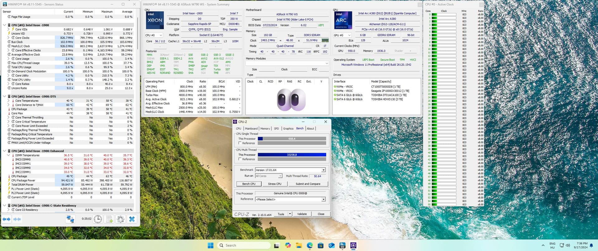

Not support the final version of Xeon,but support every ES Xeon F3 D0 stepping.
Because this is the cheapest option,you can buy for 400-500 usd 60 core cpu.
