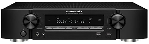

I don't think we can expect to see receivers get much smaller than the Marantz AVR linked above, unless you want to go strictly stereo. If power isn't a huge concern, you could probably get away with a couple of good T-amps and use a computer as the pre-amp or hide the audio equipment in a well vented cabinet or closet and run an IR sensor somewhere.
