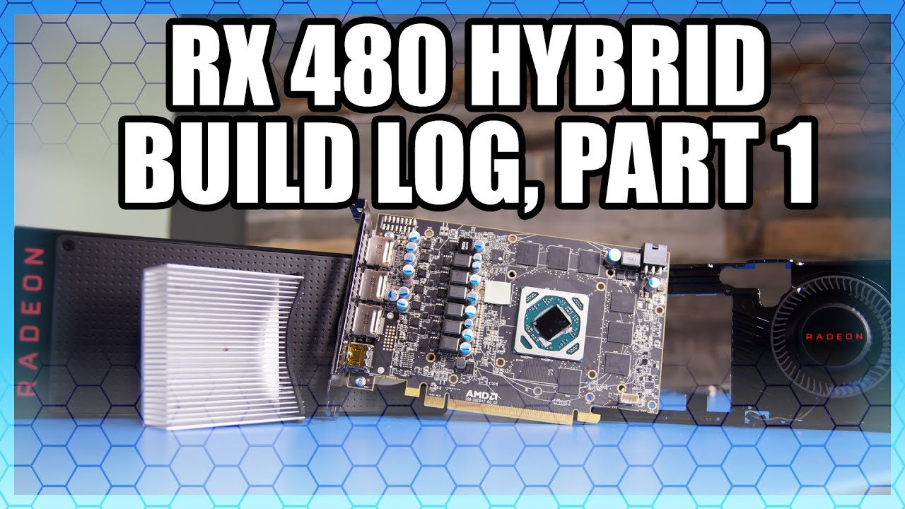

going to run basic tests, mount hybrid cooling - and sell out or give out for free on forums.
ps. gamernexus already started doing this same project as i plan
