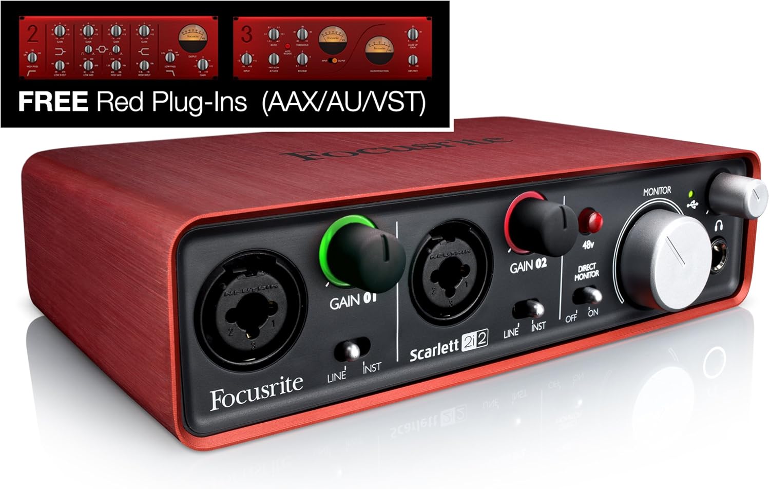

Nearly any external recording interface is better quality and value than any of the options you presented. These will not give you a significant increase in audio quality over what your motherboard likely has built in.
Do you mean something like a USB DAC?
DACs aren't necessarily great for the money either. Hardware-wise you'll find the same (or often better) op-amps, better gain stages/DSP and isolation in recording interfaces over all in one PC marketed and focused DACs

Also, I never said that integrated audio wasn't "Good enough," but I do recording week to week on several different modern, high end systems, an not a single one comes close to interface quality for anything demanding. It's nice to be able to plop a tascam or scarlett on any system and know approximately how it's going to sound.
Said it before, audio interfaces like the mentioned focusrite have limited capabilities when it comes to hard to drive headphones. I actually have the 2i2 first gen. here and to get HD650s loud, you have to max it out. That is never a good thing and you can hear it. The DAC is great, so if you have active speakers running that is totally fine. For demanding headphones better get something like a Fiio E09K on the cheap or something class A used to end it all.
