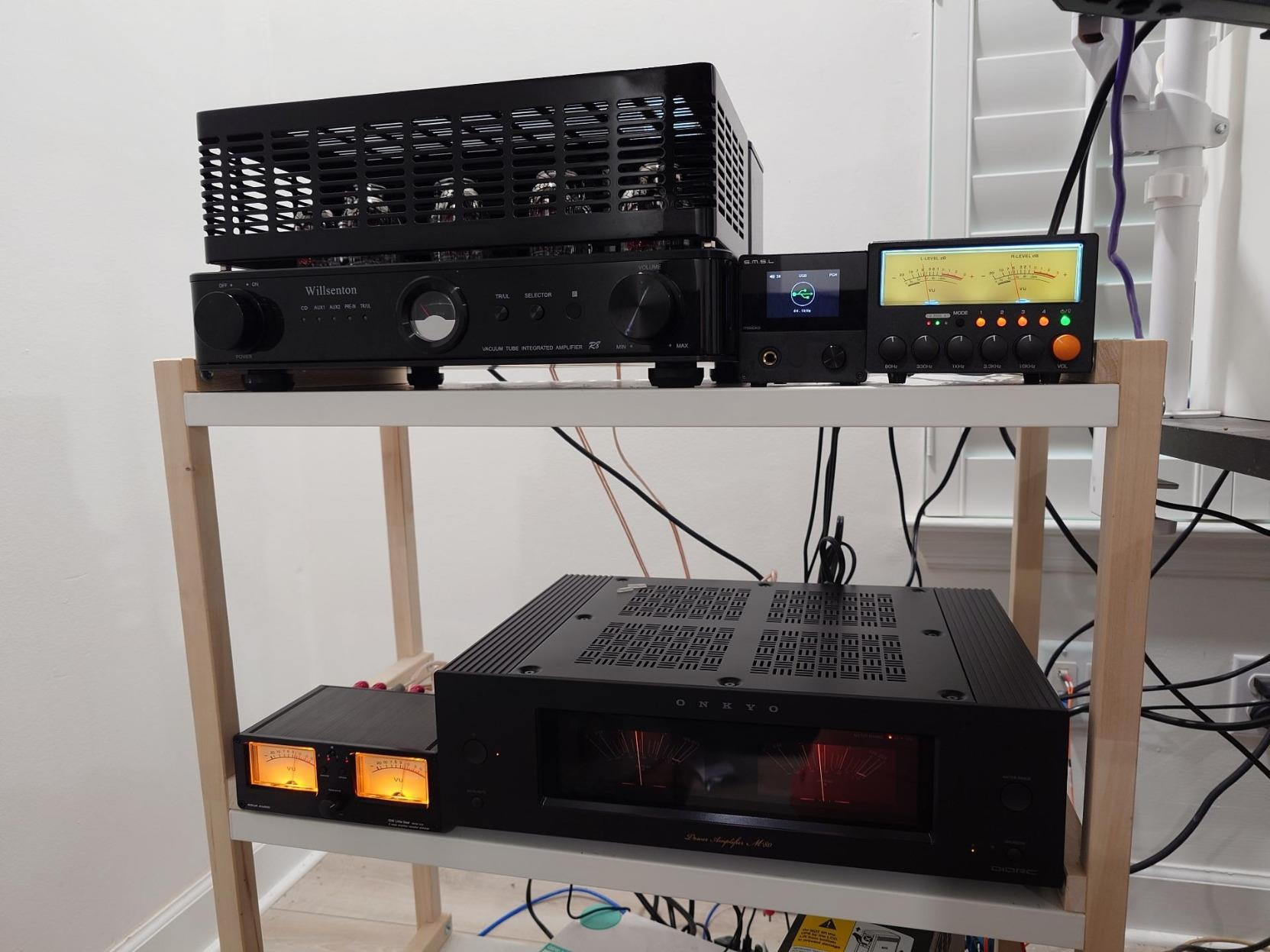

I had a ground loop isolator right before my tube amp I had hooked to my PC (after my USB DAC), but recently I switched to an Onyko M-80 solid state and it doesn’t really need the isolator anymore; has much better grounding it seems.
