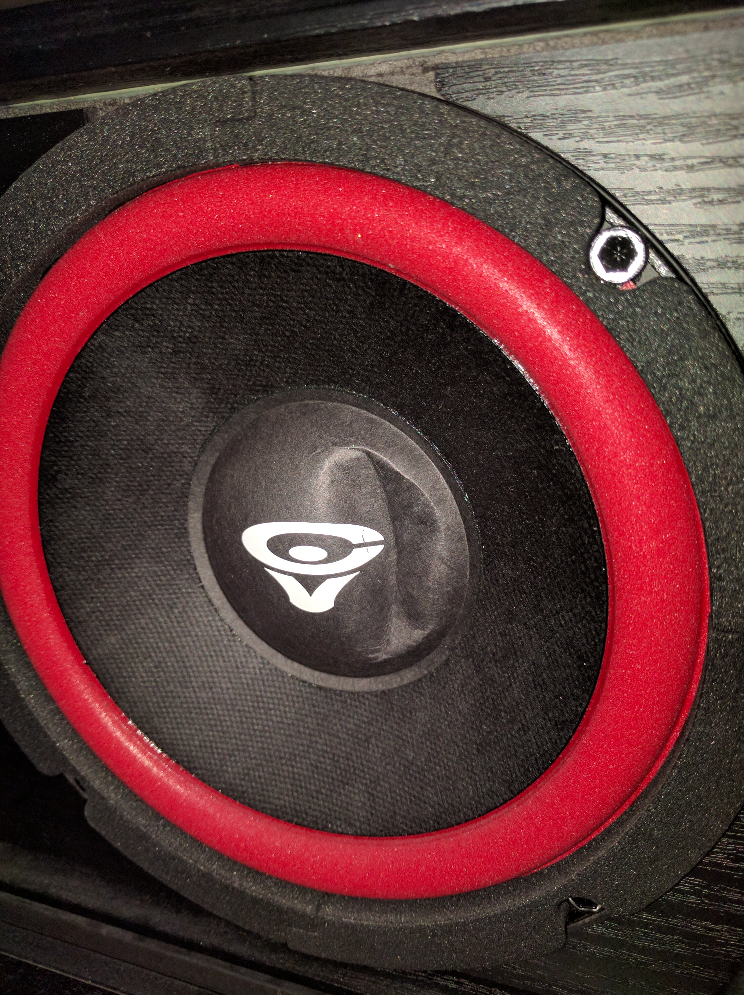

What's the best way to fix this speaker?
It fell and I’m not sure what the best way to fix this dent without damaging it would be.
I’m assuming this hasn’t made the speaker non-functional (It doesn’t look like it), in this case I’d try and pull it out with some kind of strong adhesive, preferably something that won’t leave too much of a gash where it gets pulled off. a small tab with a flat base and some superglue to pull the dent back out would be my last resort, though, and then carefully peel/cut the tab off with a box cutter or otherwise.
Take it apart bend it back clue it back together? Or just use a vacuum cleaner to pull it back perhaps? either ways a somewhat visible fold will likely remain. Or what @KemoKa73 mentioned, I guess.
Yeah it still works, and there’s nothing obviously wrong with the sound, as far as I know the dust cap doesn’t affect the sound at all, it just looks crappy.
I tried with some tape and was thinking of using glue next. It’s made of a hard paper/card material and I’m a little worried that if I put too much force on it I’ll rip it off. I could probably bend a needle 90 degrees, work it through and use it to pull it out that way.
I don’t want to do anything that might break it considering that it still works fine and I don’t really know what I’m doing.

It’s too stiff for the vacuum. I’m thinking the best way will be to pry it out with a needle or something like that, or replace it completely but I don’t really want to do that considering it still sounds okay.

Maybe I’m just doing it wrong but it’s not having any kind of effect. It’s made of thick card and the vacuum can’t really get a seal on it

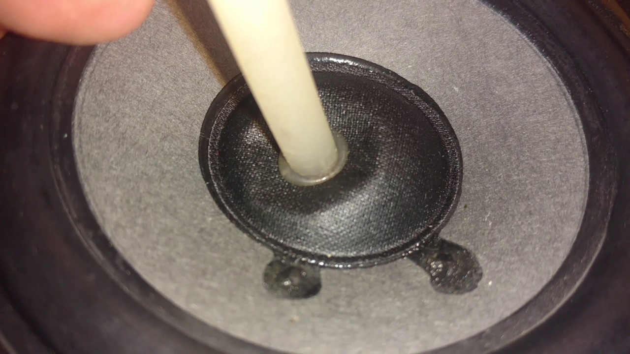

could also try the clue-stick method:

I don’t think that will work with mine, I think the only way will be to push on it from behind because trying to stick something to the front will just pull off the top layer of the paper.
