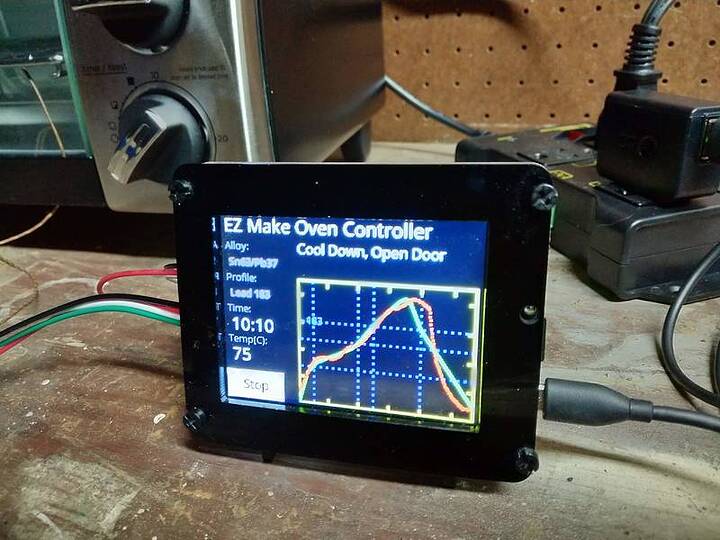

I have a friend that does this kind of stuff a lot more than I do; they’ve replaced some AM5 sockets for me and that kind of thing. The toaster ovens we made had 4-5 presets on them. They really struggle with the modern lead-free solder, though. Its a little preset program that does it (and there’s a sensor or two iirc).

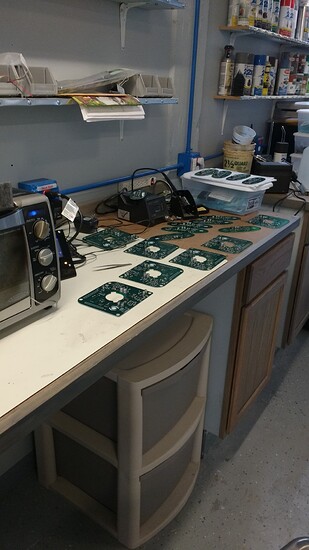

My coworkers and I used something similar to this to flow hundreds of surface mount boards at a previous gig.
It definitely works!
Hey, I even found some pics.
Leaded solder.
