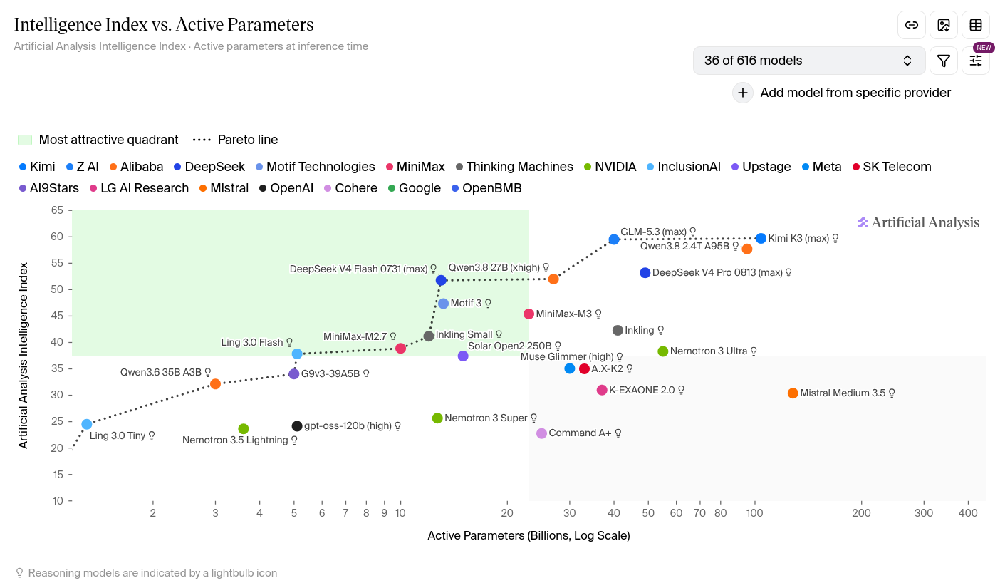

Qwen 3.8 27b is a dense model, and so it’s pretty slow. The config i have feels fast enough for me. Ling 3.0 Flash is where the fun begins. It is, in my opinion, far better than Qwen 3.6 35b and is underrated.
I know that many don’t like the Artificial Intelligence Index, but i use it as a guide to find models worth my while. Ling 3.0 Tiny, Ling 3.0 Flash and Deepseek V4 Flash 0713 are particularly good for Strix Halo as they have a pretty small amount of active parameters.
