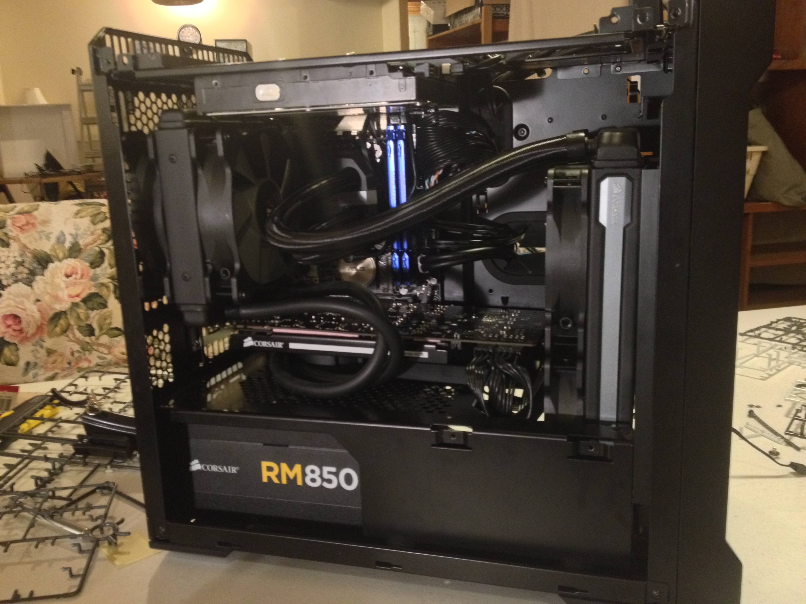

so, it all fits! i'll need a few days to test a better cpu overclock, but as of now my 4670k is sitting pretty at 4.6 ghz at 1.2 volts. it only reached 60 degrees max, so i'm going to try to throw some more juice at this puppy.
after a few days of testing the gpu, it actually still gets pretty hot. 70 degrees max, and it's not even overclocked. but at least it isn't a jet engine.
i'll report back with my stable oc in a few days.

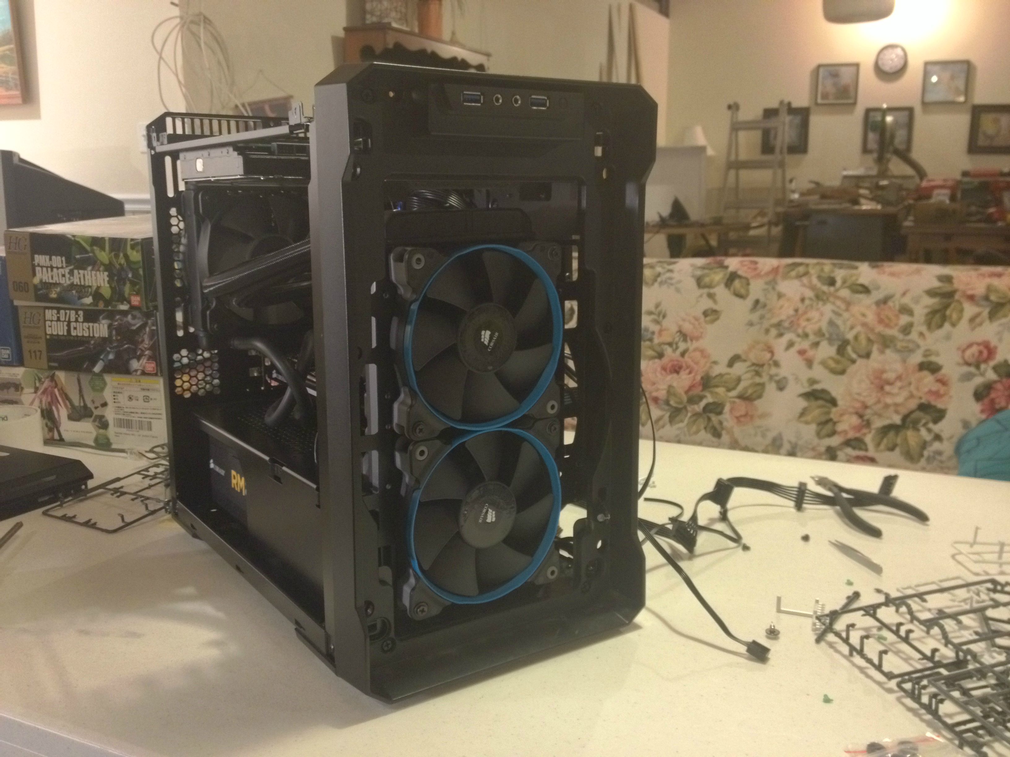

I would try powering it from a molex or sata plug to see it go at full speed to be sure. That said, it may be that you aren't getting enough airflow into the case, so the two rads are fighting ove who gets the most airflow towards the outside. You could try having the h100 pull in air instead of exhaust it.
EDIT: Or the other way around and have the h75 pull in fresh air.
From experience, I wouldn't use the GPU rad as an intake. It'll cook the insides of the PC.
OP, I'll post the fan layout of my current pc to give you an idea.
The GPU Radiator is not in the picture, but it's exhausting air in the back chamber behind the motherboard.
Is there a way for you to put your 240mm AIO in the front as an intake?
i mean, maybe? i'm not sure if i can have the rad in the front while still having my 3.5 inch disk. i'll muck around with it tonight and tomorrow.
i have a 2x3 pin to molex cable for the pumps coming in the mail tomorrow.
edit: okay, so i would have to:
  1. take the 140mm fans out and probably not use them again
  2. take the drive bay out
  3. take the "phanteks" bracket off
  4. put the h100 in the front (i would even have enough room for push-pull)
  5. find somewhere for my hard drive

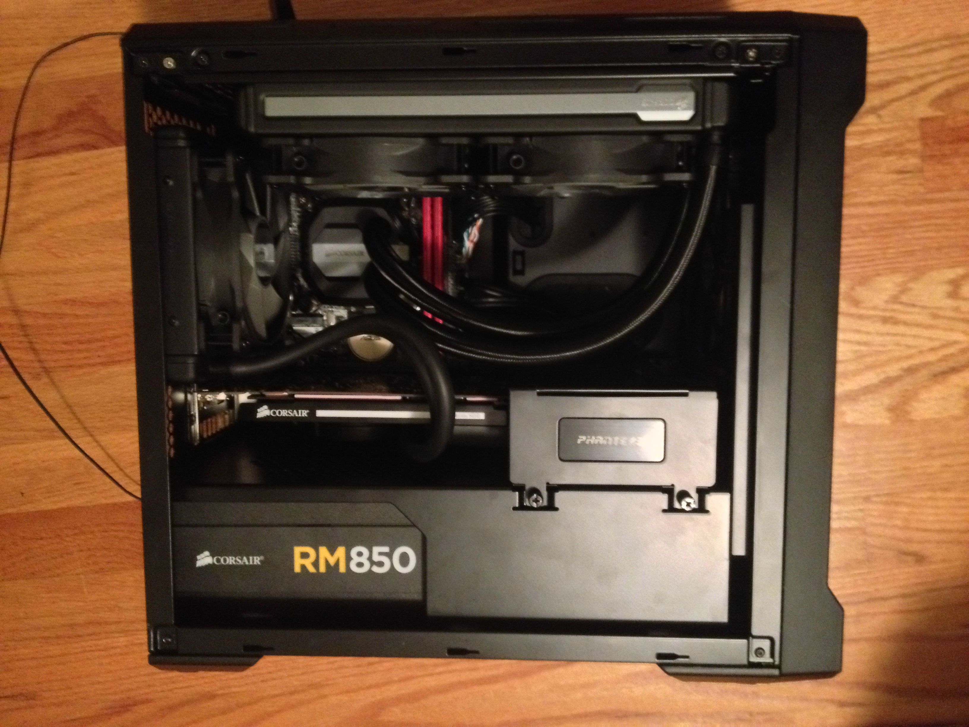

So this happened.
overall, it's really quiet now. the gpu is still a little warm (73 degrees).
i ordered an led strip for it too, so i'll show more pictures when that comes in.
