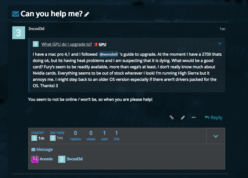

I have a mac pro 4,1 and I followed @wendell 's guide to upgrade. At the moment I have a 270X thats doing ok, but its having heat problems and I am suspecting that it is dying. What would be a good card?
Fury’s seem to be readily available, more than vega’s at least. I don’t really know much about Nvidia cards. Everything seems to be out of stock wherever I look!
I’m running High SIerra but it annoys me. I might step back to an older OS version especially if there aren’t drivers packed for the OS.

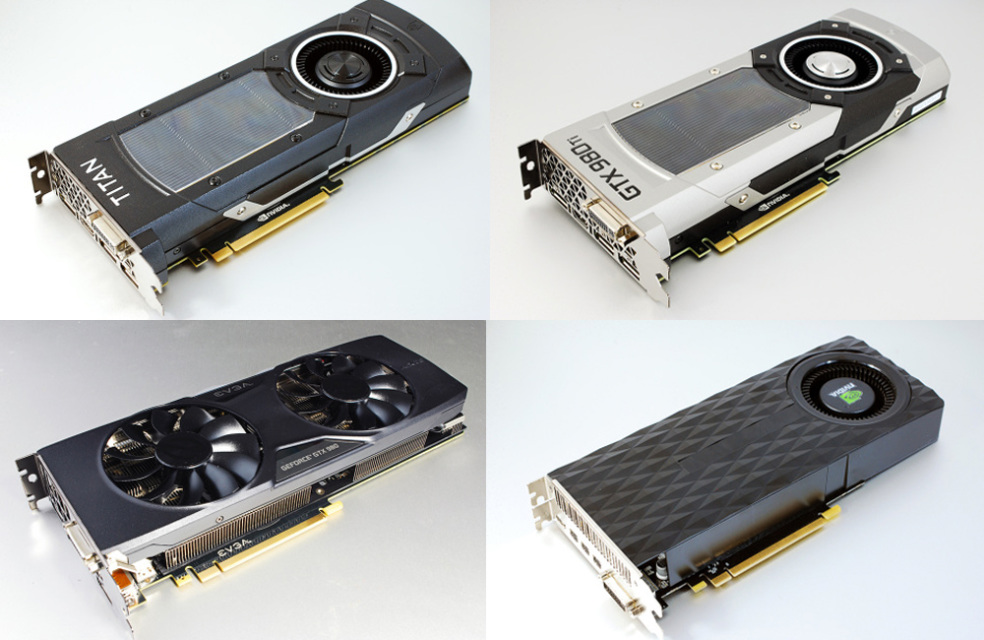

The 980Ti is going to be the most stable high-end nVidia card (excl. Titan / Quadro) for OS X 10.3 driver support.
There are 10 series drivers out there but they are still in Beta, no final stable release is out yet.
The AMD cards will work much better under OS X than the 10-series. I’d probably go for a Vega 56. The Fury-X is an option but you will need to deal with the radiator and there is only 4Gb VRAM on-board although it depends what you do.
If you need CUDA then definitely nVidia otherwise, I’d probably go for a Vega 56.

What originally got me here was this post.
Is he still around? I haven’t seen @FaunCB today.
I might also ask on IRC, but I will keep a 380 or 390 in mind as @DerKrieger recommended in the lounge earlier.
I can say right now that I’m running a GTX 1060 using Nvidia Web Drivers (stable release) on macOS Sierra just fine. The only issues will be with the 1080 Ti and the 1070 Ti, as those are newer cards.
GTX 1080 plus the Nvidia Web Drivers should serve you well on that Tower Mac Pro. It won’t run PCI-E 2.0, but it’ll still run.
The only way to make a Nvidia card run PCI-E 2.0 is to get a Mac Pro flashed 980 Ti. But for stuff that doesn’t use the PCI Express bandwidth too much, PCI-E 1.1 x16 is enough for a GTX 1080, no flashing required.
