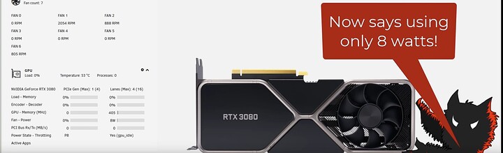

I’m seeing examples of people claiming they can get high-end Nvidia GPUs idle power use down to under 10 watts in Unraid:
In contrast it doesn’t look like Intel Arc GPUs are anywhere near as good about idle power. They seem to regularly idle between 15W-40W depending on the details.

That seems pretty damn good to my uneducated eye. I feel like anything under 10W idle would be acceptable.
