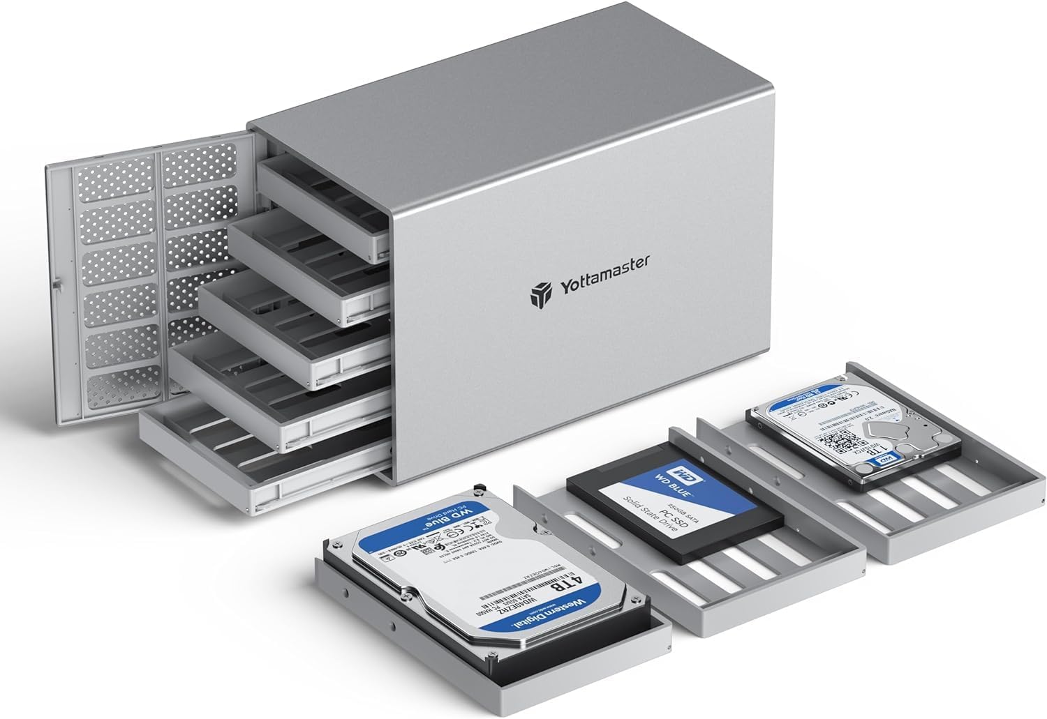

Here is a USB 3.0 cabinet with 8 slots for ~$200-$225:
And then you can get 2x Seagate Exxos 18 TB for ~$600:
If that is too expensive for your budget, 2x12 TB is $400 and 2x8 TB can be as low as $250. Going lower is not recommended today, seeing as 2x4 TB SSDs cost $300-$400.
