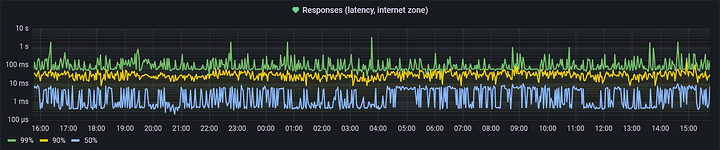

Hi, I’m back with probably weird problems nobody else has. I have noticed that at random times and with random IP/domains I have random latency, sometimes multiple seconds long. Of course I did initially suspect DNS but my DNS latency looks fine, at least server side:
(If that happens to the device it’s not just happening once, but it’s like for every single site and for quite some time, the browser seems to connect to the site and then stop, it’s sadly mostly on mobile devices so hard to see more than the loading bar, expecially in the instant it happens)
It seems to stem from building up the TCP connection and even package loss some times I think.

Sorry I won’t be able to help, but that graph is very cool, what are you using to capture and present the data?
That’s grafana with a Prometheus capture source getting data from CoreDNS

From your chart in OP, a couple of DNS requests did exceed from 1s and up to 10s. Seems randomly did so.
No, plain Ethernet.
That’s correct it’s too few that I think it’s the issue, but I’ll investigate, I think I can get request logging out of core DNS. Maybe I’m just too dump to read charts or so.
