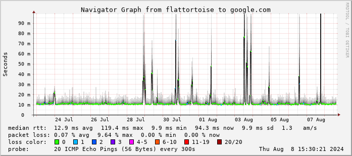

Yeh, good ol comcast, Looks like something started happening at the end of july
