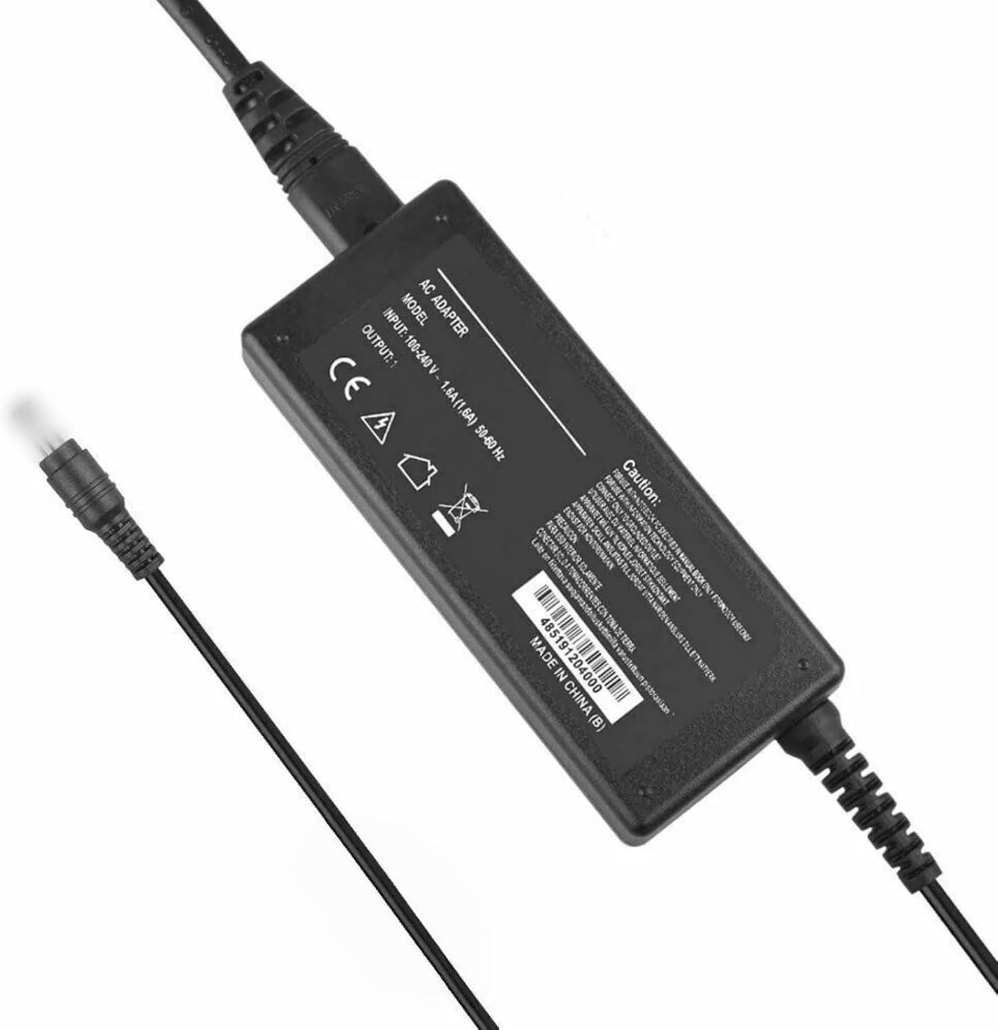

I have a tiny 10" rack that has 4 devices running off 12V 1-2A wall warts.
(There’s also one 19V 120W brick).

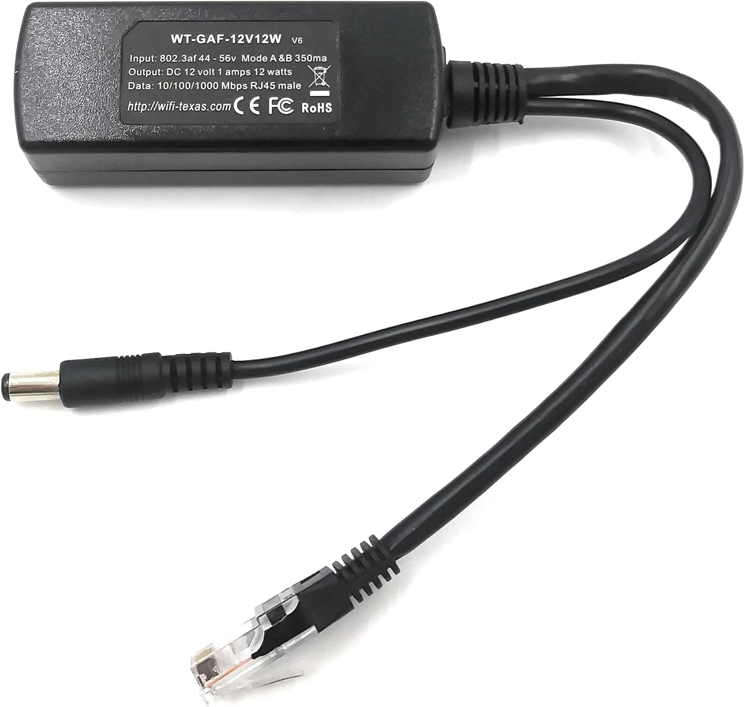

Yet another option would be to use a PoE switch with 4x 12V splitters, but that is a bit ugly and bulky.

Reading this sentence as if you already have a POE switch.
Then this is a possible solution:
