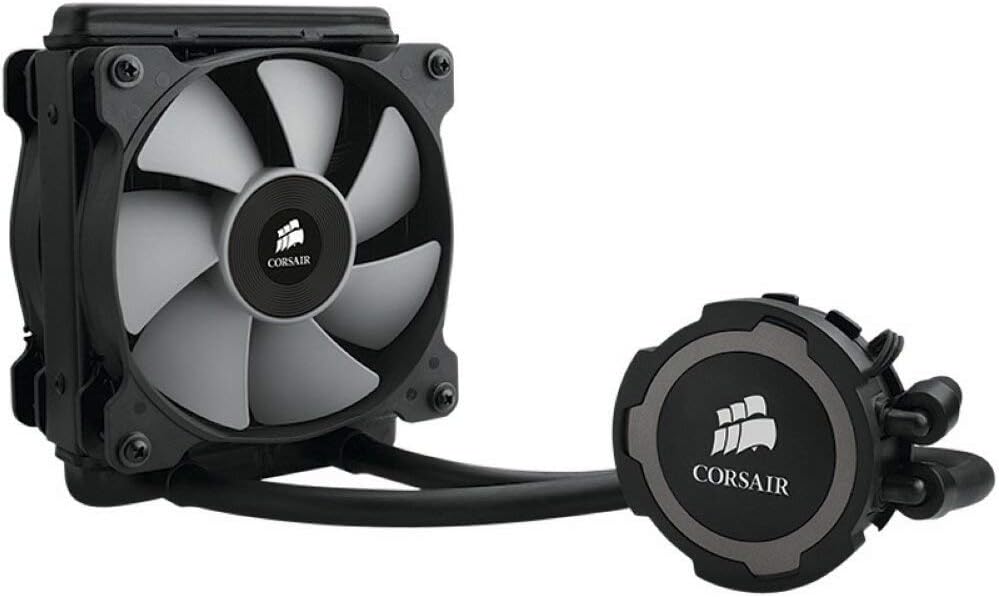

I am contemplating this one I think it should fit.
Well I am impressed with this water cooler. The new box alone dropped my temps just because of air flow, however i got 20 degrees less temperature with the water cooler. I also clocked it to 3700. I stressed the cpu with cpu-z and it never hit 55 degrees. When I stress tested with the 1700 stock cooler at 3.6 it hit 75 degrees. Well i guess I can move into p-state overclocking now, but that is for another thread. Had I known there would be this much difference, I might have water cooled a little earlier in my life. :slight_smile:
