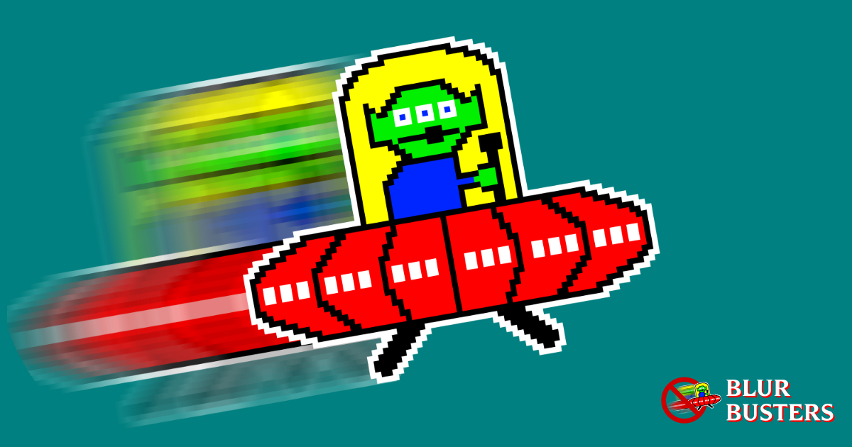

This inverse ghosting is a result of turning "Response Time" to on in the settings menu. Turning it off elminates the ghosting but raises the GtG pixel transitions to 8ms (from 5ms). It's personal preference which bothers you worse, the black trails or the inverse ghosting.
Not sure why you're dragging icons around and scrolling text, you can clearly see the difference between both settings using the link below.
https://www.testufo.com/#test=ghosting
