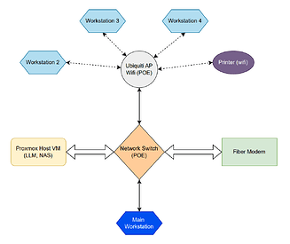

Another issue i’m trying to solve is the networking since I have 0 knowledge on this area. This is the basic diagram i drew for the home network.
I need to find a network switch that can do POE and preferrably 10gbe and maximize the data transfer between proxmox and main workstation. does it make sense to get a 10gbe rj45 pcie network card for main workstation + proxmox host? if so, what network switch should i go for?
